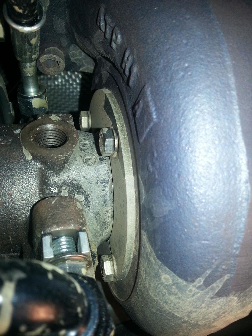

I'm not sure if I need to plug off the other two threaded holes in the turbo or not. I'm guessing they are for coolant. There don't seem to be any plugs in the kit, but I hate to just leave them open.

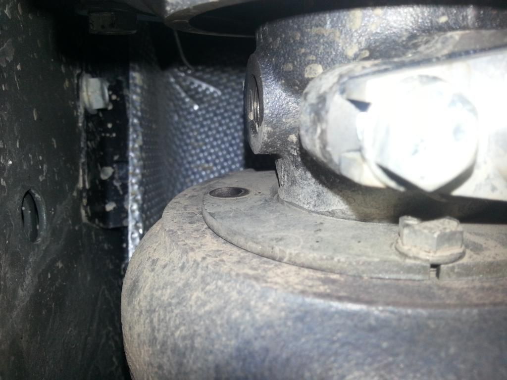

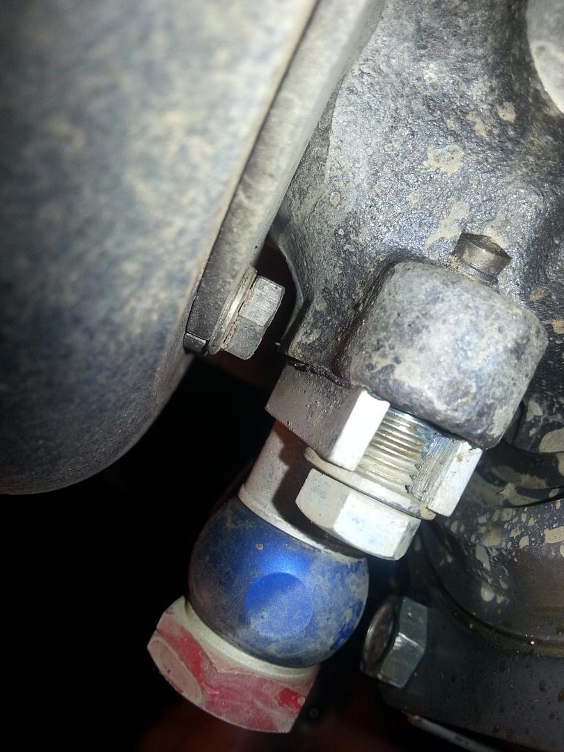

Here's the only pics I was able to get of mine. Hope they might show you something?

Thanks Rich, that does help with the oil return fitting position.

My turbo coolant ports are left open, no plugs.

Guess I'll just leave them open then. Not sure what to use to seal the oil return flanges to the turbos. No gaskets in the kit. Not even sure if they need a gasket but i might just use some copper rtv on them.

Ummmm. Pay no attention to the mud. These are old pictures, I lived on a dirt road
Lastly, Make sure your hot end inspection flange bolts are tight. maybe add a tiny bit of loctite. I lost one at one point and had to replace it. Skulka222 lost some too.

Yeah i see silicone on that flange so i should be good there. And I'll be retorquing everything after a few miles and recheck every once in awhile. Do you run the skid plate all the time or no?

Yeah, it looks like silicone. I do use the skid plate all the time. I've scraped it a few times on speed bumps. I don't want to rip off one of the oil lines.
just use rtv
