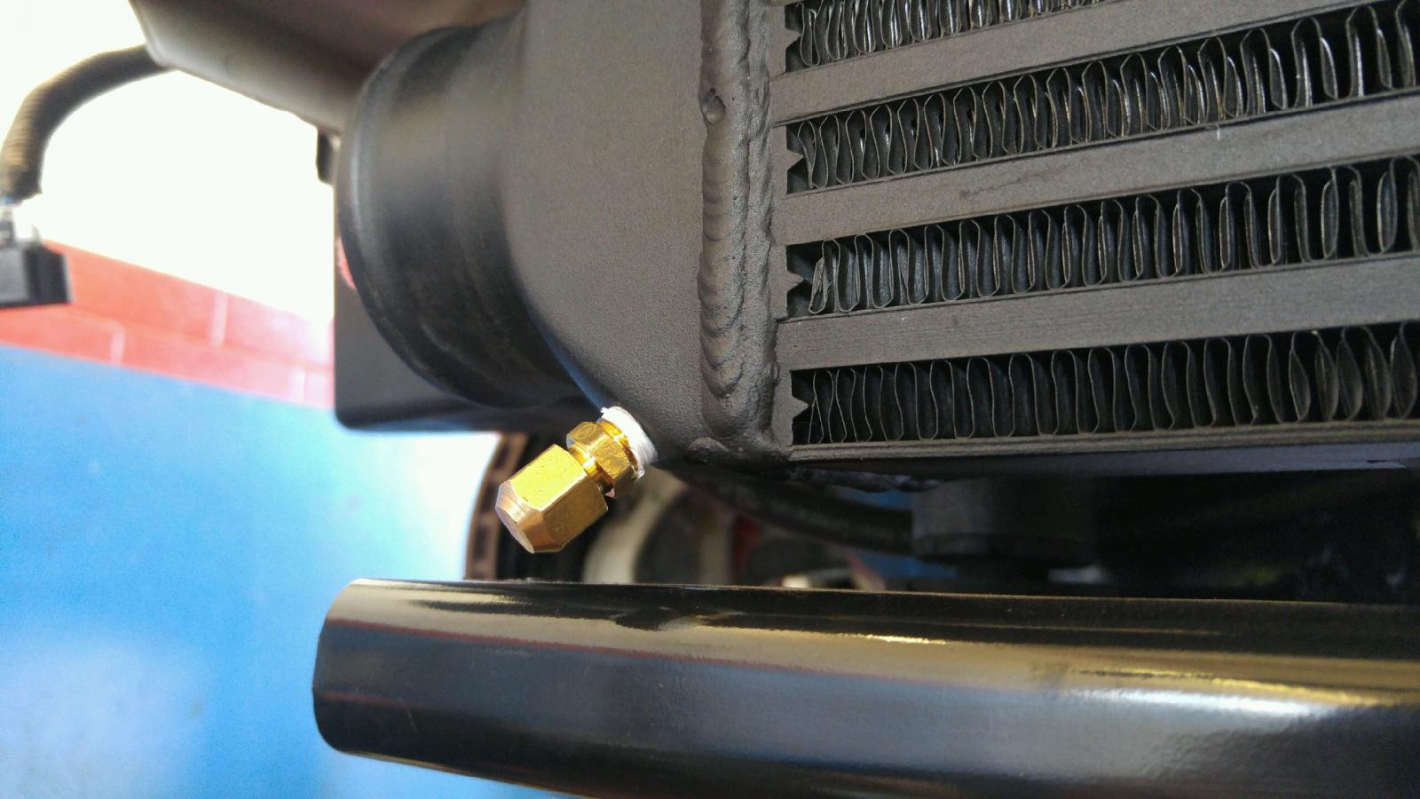

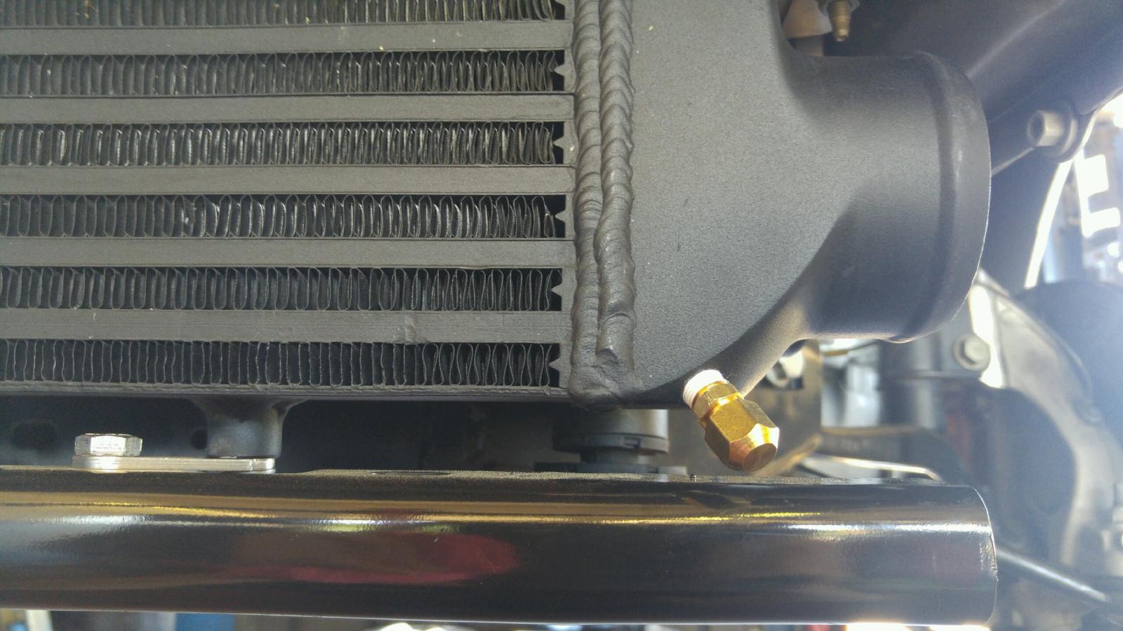

I added another safety feature today. I put a fitting in each side of the intercooler with removable caps. This way I can remove the caps every so often and make sure I'm not collecting oil again. This will be a quick easy way to check without removing my bumper and boost piping. Maybe it's not needed but it will make me sleep better at night.
