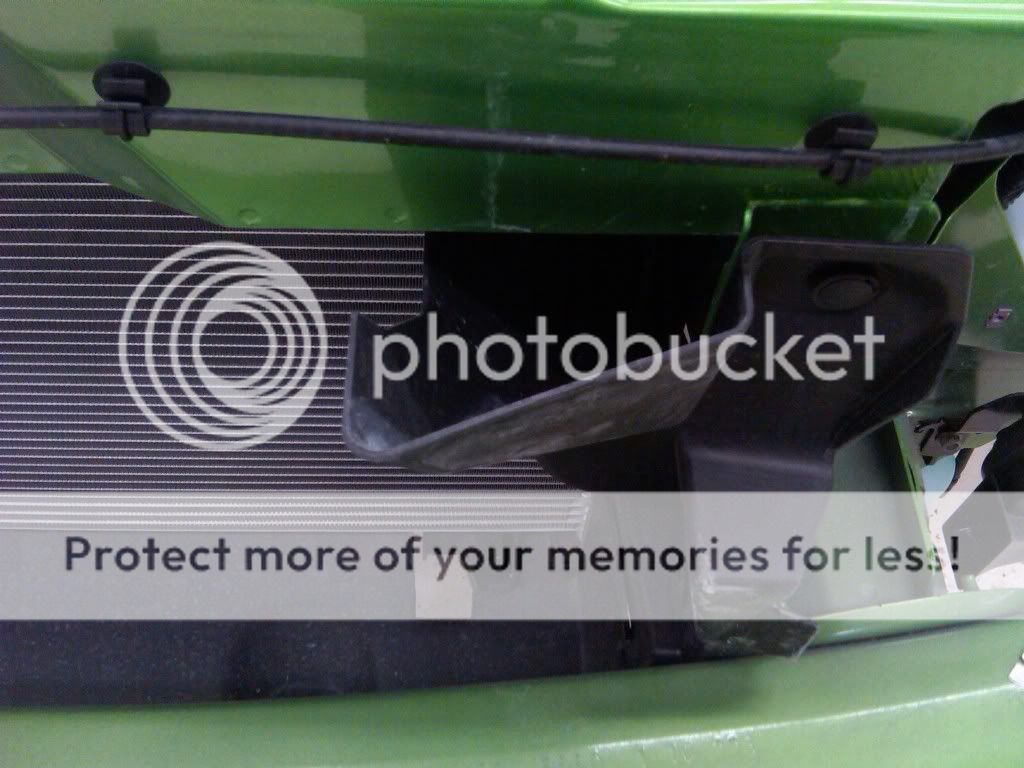

Good question. The stock inlet duct is located behind the grill on the left side. You can see it through the grill once you know where to look. The duct feeds air around the radiator and straight into our air box area.
The stock air inlet duct on the ZL1 appears to be identical to the duct on all other 5th gen Camaros even though the car is pushing nearly 200 more HP. This is one of the reasons we started developing the Big Gulp so quickly.
FYI, although our Big Gulp will allow more air to the filter and air box area, all of the testing so far has been done using the stock inlet only. (please note- although we have inspected the ZL1 duct closely, the pics posted are actually photos of SS cars)

I saw that plastic piece in the picture behind the grill but didn't see the scoop at the top. Ill look again. I was thinking to remove that plastic scoop al together. Would that let more air into the enclosure and filter?

The stock duct makes the air change directions to prevent water intrusion to the intake tract. We DO NOT recommend removing the stock duct. To do so will give water a straight path to the intake system which can result in motor damage-more accurately, motor death! If you want more air to the intake, we recommend the Big Gulp system. FYI, the Big Gulp will also have a feature to prevent water intrusion.
