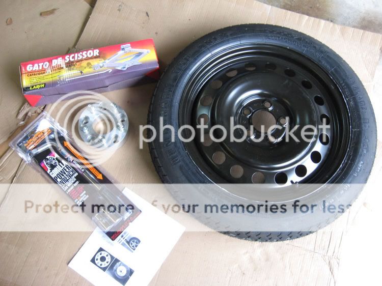

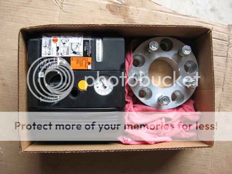

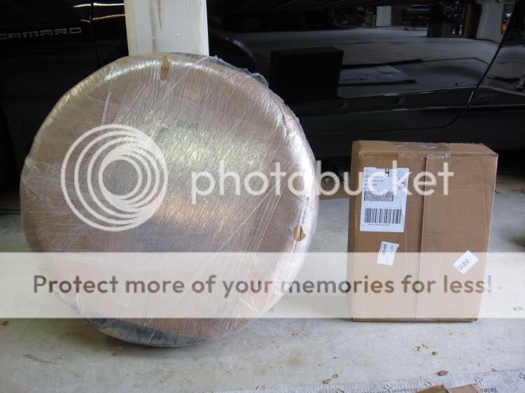

Here's the two packages I received yesterday, and their contents:

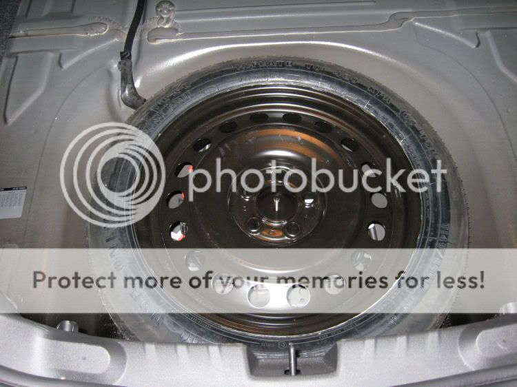

I was surprised at how big the 'compact' spare was, and worried that it would not fit in the trunk storage space. The diameter of the tire is 27" as compared to 28" for the Camaro's OEM tires.
To my amazement, it is a perfect fit in the trunk, and is certainly the largest tire that would fit.

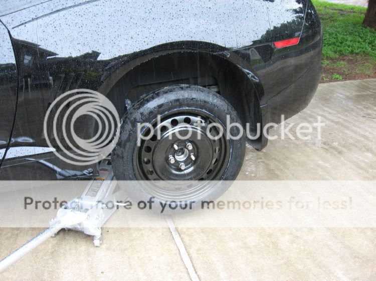

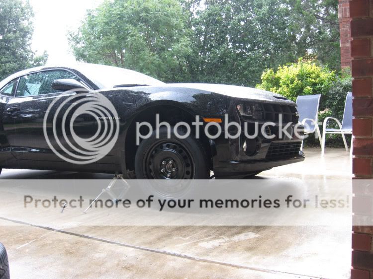

Next, I test mounted it on the car. The scissors jack fits the jack points perfectly, and is pretty easy to operate. The provided lug wrench is good quality and fits the lug nuts and the smaller spacer nuts. The only problem will be bolting it onto one of the front hubs - its hard to tighten... I guess you really need someone to hold the brake when you tighten them down.
Here is a shot of the provided spacer, which appears to be a good quality piece and fits well.

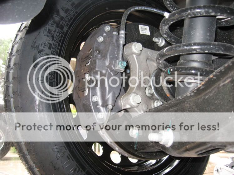

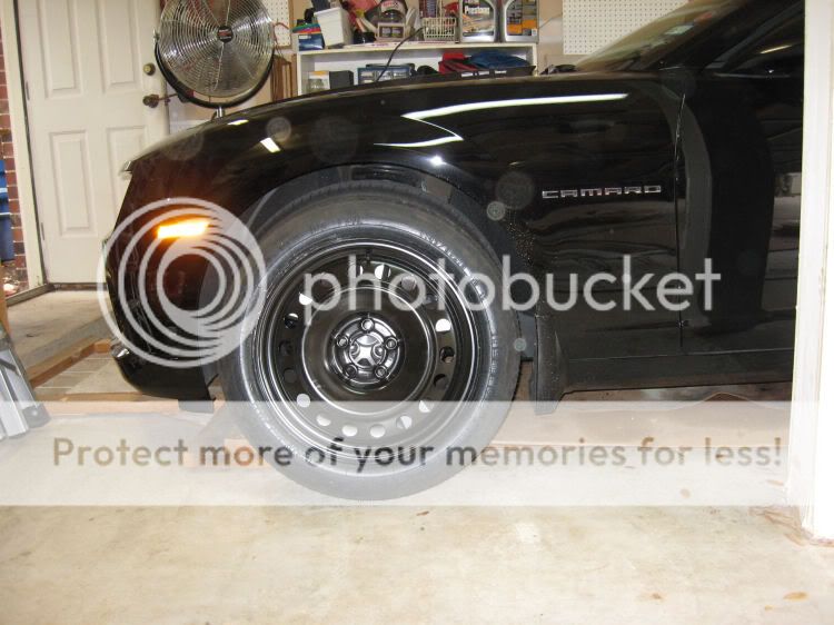

The spare fits well and easily clears the front Brembo's. NOTE: I had the roller skate style brake pads, but had already replaced them with Hawk ceramics. I doubt that the spare would clear that type of weights.

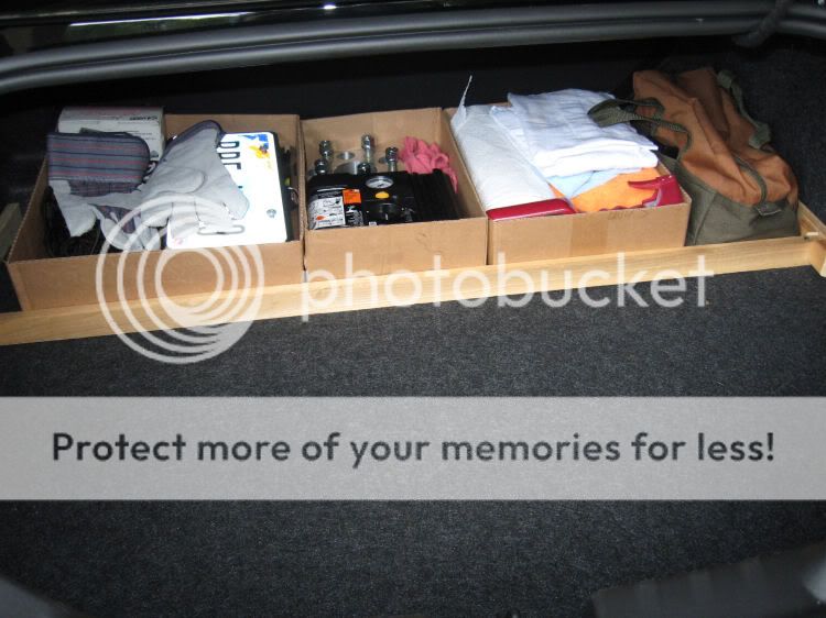

There was plenty of space in the trunk below the spare, so I wrapped the jack in a towel and placed it to the rear of the battery. I wrapped the lug wrench in a smaller towel and placed it in front of the battery. The spare easily fit over these items. I'll have to drive it around and see if I have any rattles.
It didn't look like the spacer would fit, so I just put it in the trunk after I stowed away the spare. I also put the small inflator in there as well, just in case I ever need it. You know how your donut is always flat when you finally need it...
As requested, I test fit the spare on the rear, and it fits fine...
there is at least a half inch of clearance from the caliper

Your trunk looks mad ghetto, with that exposed wood and cardboard boxes.
Safety>>Style I guess..
