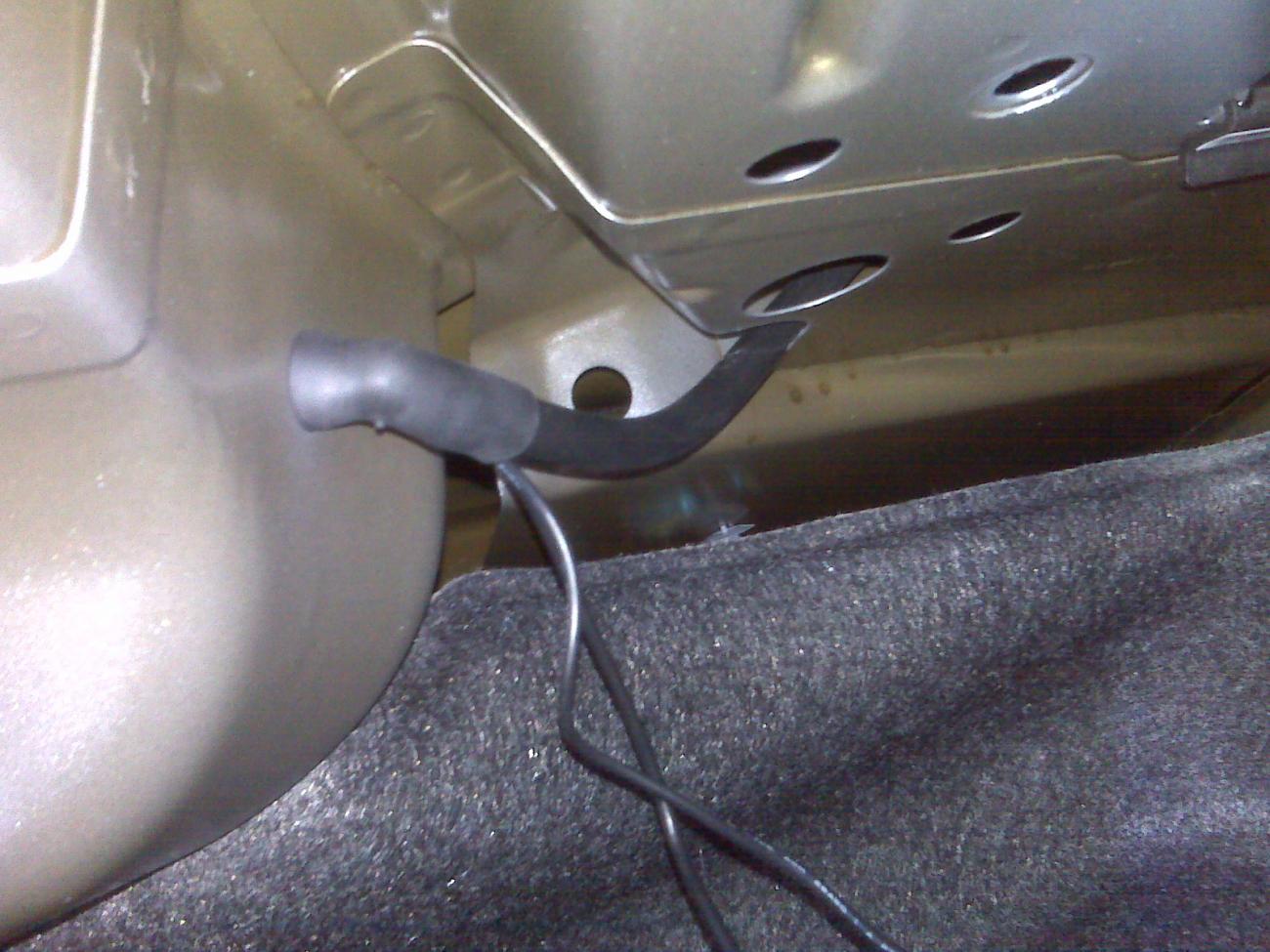

I found a different way via this grommet that attaches to a rubber hose inside the trunk. Just unplug the hose from the grommet inside the trunk and pass your wires through. Push the hose back in, and it appears to give in far enough to give you what looks like a water-tight seal. Regardless of how you do it, you will need to cut the video wire and then splice it back together, or solder it to a new plug. I had some spare plugs, so I chose to solder, but splicing should work fine too.
