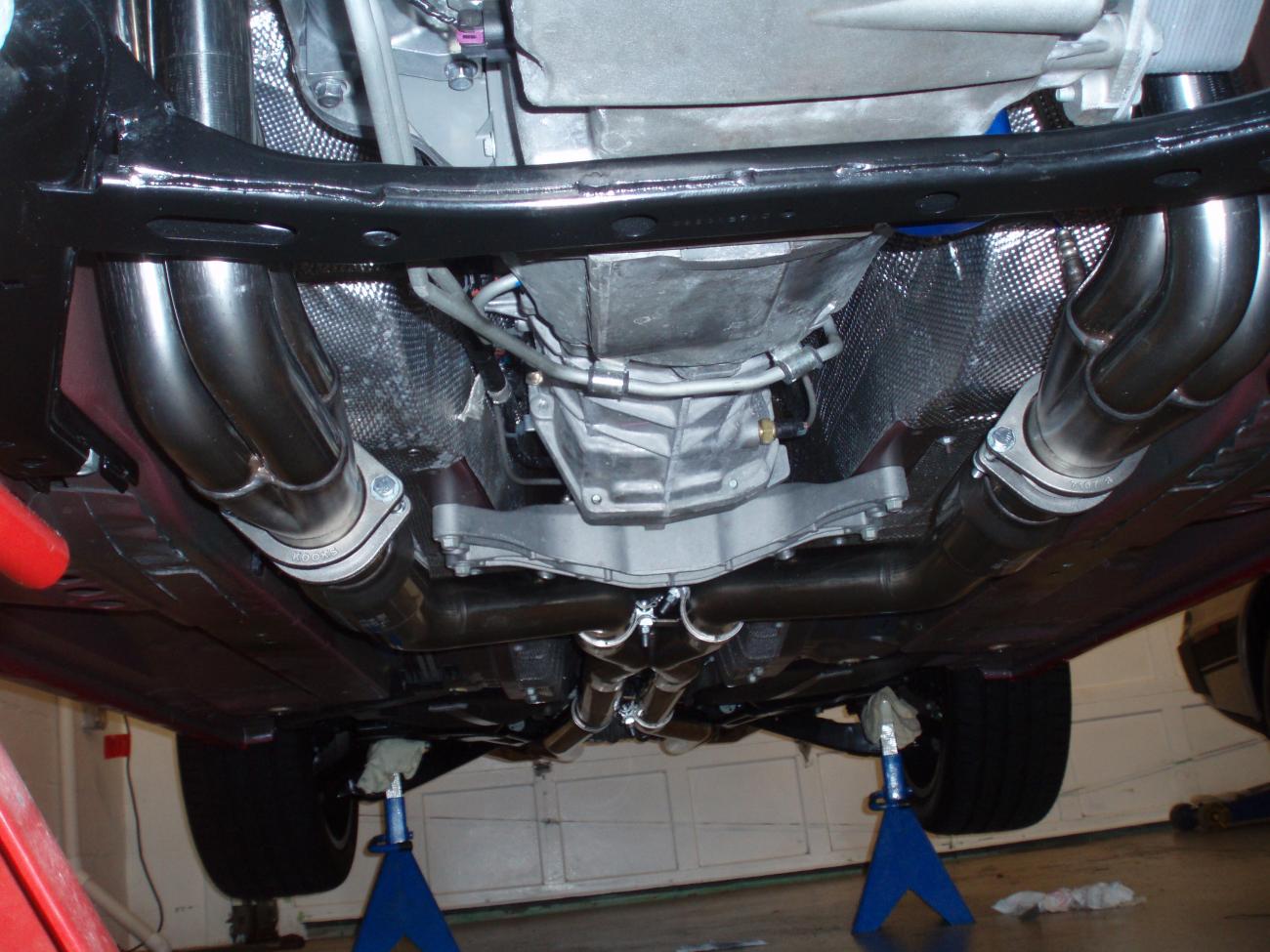

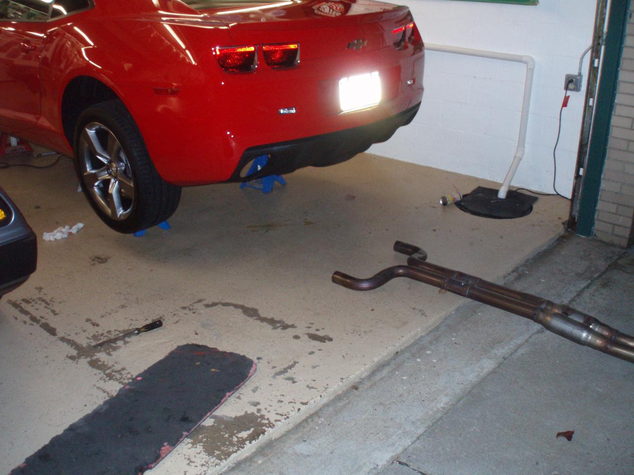

Old 12-14-2010, 08:35 PM   #7
Big Daddy Kane
Big Daddy Kane's Avatar
Drives: Red 1SS
Location: Bethel Park, PA
Posts: 195
Heres a pic of when I was installing my long tubes. There was plenty of clearance with the car at this height.
