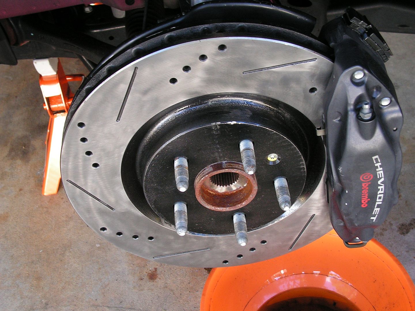

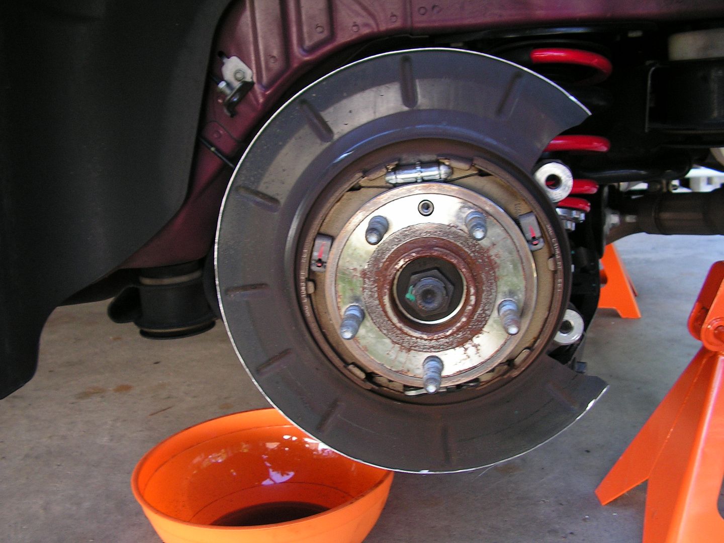

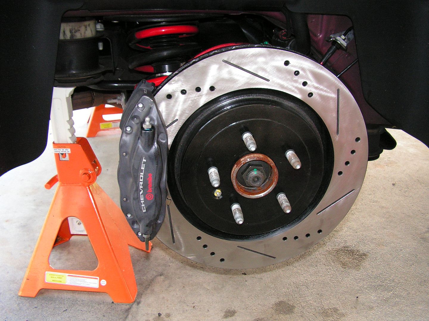

I installed the Brembo calipers, braided lines, and drilled/slotted rotors today. I had to trim the rear dust shield to fit the larger diameter rotors.
Total install time = 6.5 hours
Total cost $880
The rear setup...
And the front...
Front
Rear
