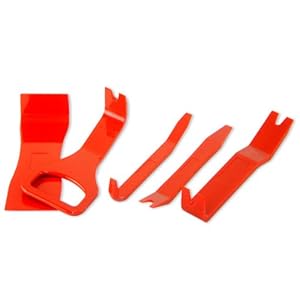

What supplies do you need? I used the following:
Trim removal tool kit.
You can purchase from Amazon, Crutchfield, etc. Picture below.
