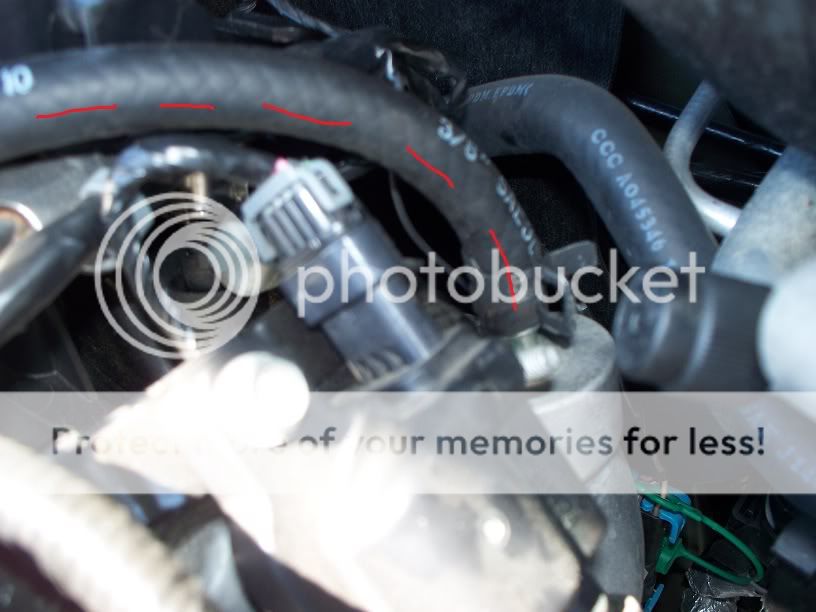

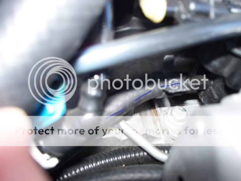

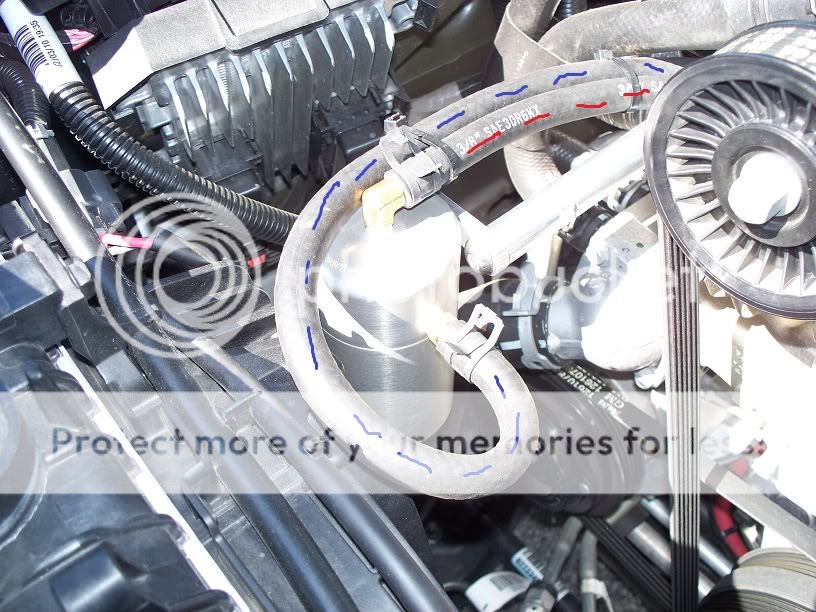

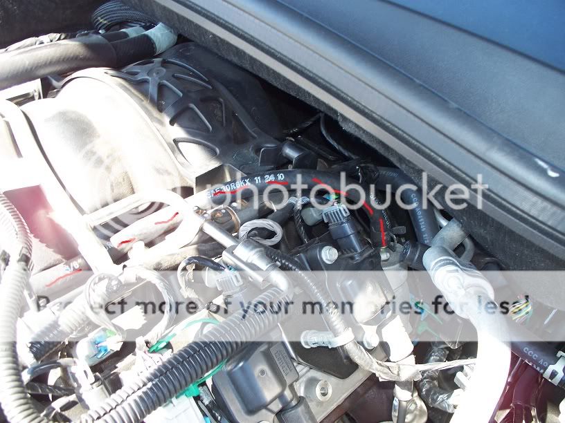

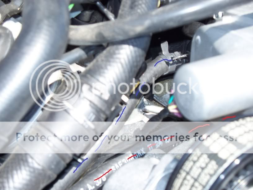

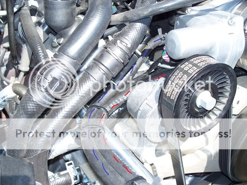

Here are some pics i just took. blue goes to the intake, red is to the pcv system.
I was able to clear the code with my sct tuner, but i just want to make sure if there is anything i need to do or worry about.
Thanks for the help!

This does point to the MAP and wiring harness. Your install looks good so I'm guessing either the connector is loose on the MAP or the wiring in the connector isn't soldered properly to the terminals. Also, if you removed the wiring harness from the MAP (I know I do when I work on mine), remove it again and check to see if any of the pins are bent.

Your install looks correct so I have to agree, check the MAP connector. If it does not come back on your good though.
