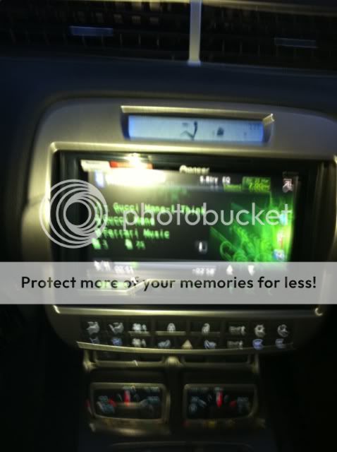

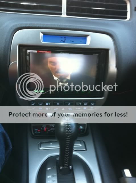

Just got done installing my metra dash kit and Pioneer AVH-P4300DVD 7" install was straight forward but the metra kit seems not to be operating everything the heated seats button does not work even though it's activated anybody else having this problem with this unit?
