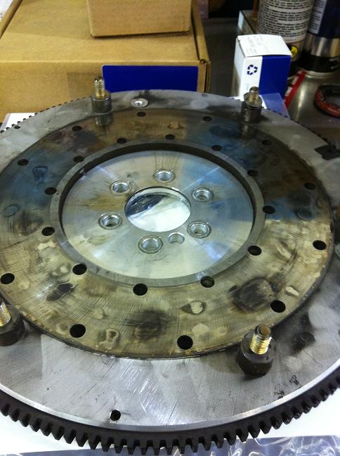

here some pics of my old clutch ( ram ) ... and new ZR-1
:mad0 260:

First, a ram twin is good for about 700 hp. Second that clutch (ram) looks fine to me. If it was working ok why change?
flyby is offline   Reply With Quote

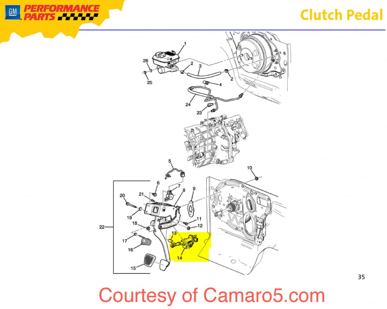

This is strange and disappointing since I just purchased the LPE clutch for mine. I haven't had it on the road yet as I am at the tail end of a supercharged 416 stroker build.
Not sure whether it makes that much of a difference, but those who have added a separate clutch fluid reservoir find that it has solved the problem IDK. There are a number of theories on why this happens, some say it is fluid temperature, some blamed it on the stock pressure plate but I don't think anyone has actually found the real cause. If it is none of these, that only leaves the master clutch cylinder. The last I heard, there is no replacement or upgrade for the master cylinder.
Name:  Clutch & Brake Assembly.jpg

Not 100 sure, but, clutch looks just fine with some normal wear.
I agree seems like some normal wear on the flywheel to me. The RTrack with 900 series discs (steel) are rated at 1300hp., this one looks like the Force with some kind of carbon fibre discs.
Attachment 263207
Hey Matster; You may be right on. I thnk lot's of folks just get the return spring from LPE as a quick fix, but a separate reservoir may resolve the issue.
