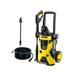

I was tired of dealing with hard water spots after washing so I purchased a pressure washer and distilled water (DW). Wow...how relaxing it is now to wash the car. No more stress over drying the car like a mad man to minimize spotting. I have used detail spray for post wash drying but I was seeing hard water scaling under the hood, under the trunk lid and in all of the little nooks and crannys. So I purchased the Karcher K3.740. It has a variable tip on the spray wand so you are not "pressure washing" your paint...very cool. The best part of this unit is that it has a self-priming pump so it will pull water from a standing water source...such as a bucket of DW. Most units require the 5-6 PSI water pressure from the water source. So I purchased a 6 gallon water jug and filled it with distilled water. I ran a short (6') garden hose from the washer to the jug and it works like a charm. I have my two wash buckets filled with tap water. I rinse off the whole car with DW...wash the top surfaces...rinse...wash one side...rinse...wash the other side...rinse...rear...rinse...nose...rinse...wheel s...rinse...then a quick overall rinse. It used every bit of six gallons so the water is just under a buck so six bucks for a wash. Obviously there was the initial cost of the pressure washer but I will have other uses for it so it is a win-win for me.

Great idea! I have been thinking about doing something like this as well. I work at a hospital and our Dialysis unit uses RO Water and I can get as much as I want for free. I have to see if my power washer will self prime.
