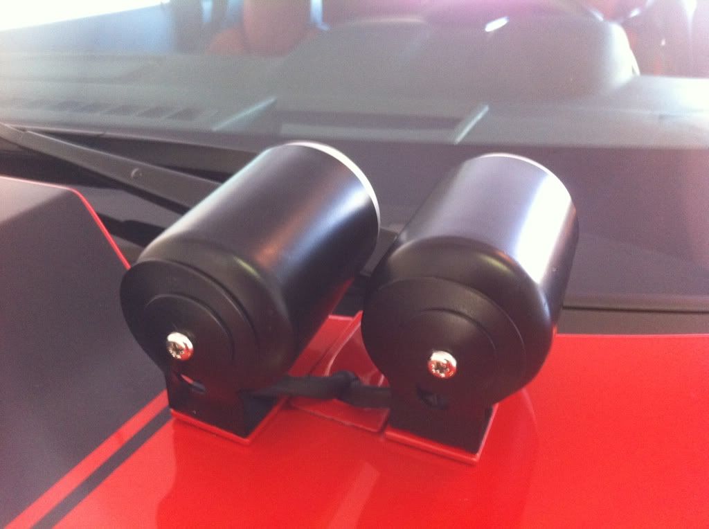

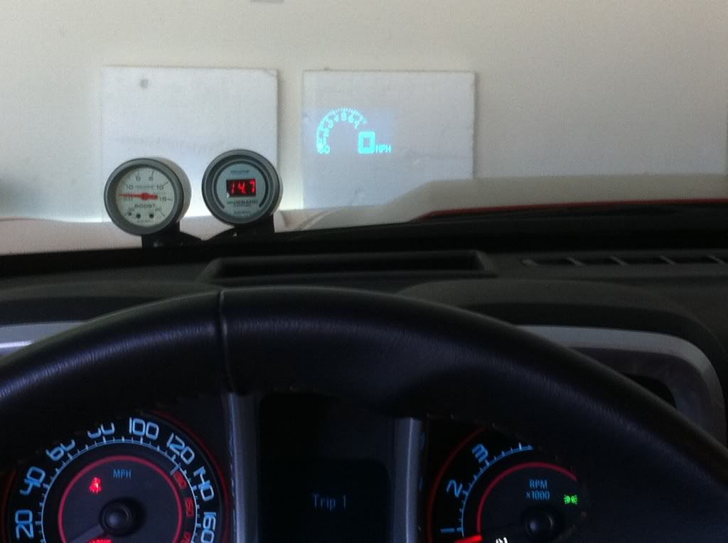

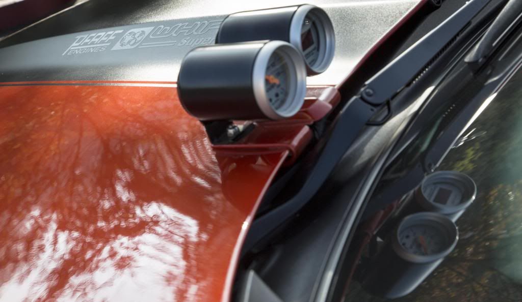

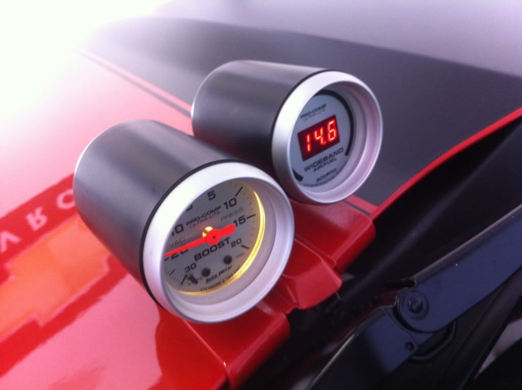

I went old school and made some hood mounts for my SS

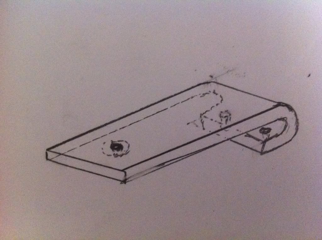

Originally Posted by BUMBLEBEE_SS View Post
That looks pretty cool man. Sweet idea
Thanks.
The brackets are made from 1 1/4" and 1/8" mild steel ... I used a strip of aluminum from a soda can as a template to get the size/angles right.
They are held onto the hood with decal tape to prevent scratching.
They are clamped under the lip of the hood with grub screws that screw against small strips of aluminum to prevent dimpling.
The gauge pods are held on with counter sunk stainless bolts and nyloc nuts.
I made the cable cover that goes between the brackets out of a recessed sliding door handle.
Note ... They now have black screws holding the gauges in the pods!

It doesn't touch anything when you pop the hood?
No ... heaps of clearance.
