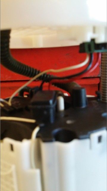

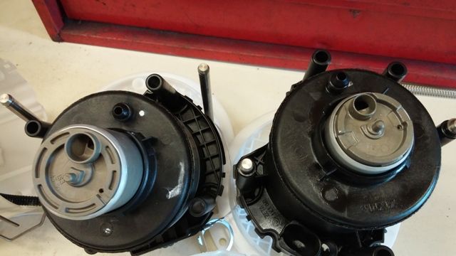

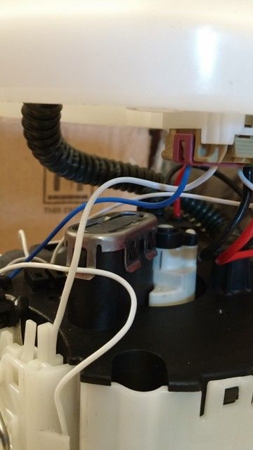

I had a thread a while back asking how you could tell the difference between a ZL1 pump and a stock SS pump but nobody seemed to know. Here are the pics now that I removed my stock pump and put in the ZL1 pump.
Stock SS
ZL1 has metal cap and pump sticks out of bucket farther.
As for how much better it might be than stock...
The port is quite a bit bigger (ZL1 on left)

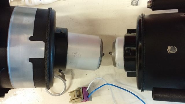

and the pump itself has a larger diameter and is longer. (ZL1 on left and it was not seated so pic makes it look longer than it is but it is longer)
