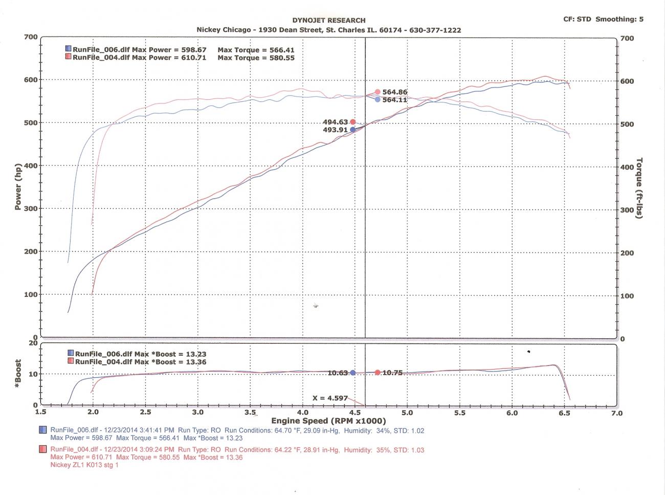

How do these numbers strike you fellas?
Max Power: 610.71
Max Torque: 580.55
The 13 recevied Kooks 2" LTH, Kooks straight connection pipes, Pulley upgrade, fuel injectors, Nickey plug wires, roll cage, a ATI Damper, my harness was installed on my Corbeau seats, and a tune. All work done by Nickey Super Cars in St. Charles, Illinois.
The mission: Get me back in to the 600hp Club while keeping my ZL1 street friendly. They even did it with less boost than my last ZL1 needed.

Also be interested in what % O/D you did as I just finished watching the HellCat video and it put down 622hp so you're right there if you should happen to run into one. I absolutely love my car and I really don't care about losing a race but I don't like getting blown away. I was looking at a similar package as yours and doing headers w/no cats, 10%, tune and I already have a CAI. Hadn't thought about injectors but maybe I should. Have to do some kore homework so please do let us know on the O/D.

One thing to keep in mind with doing just these mods is heat soak. It isn't a problem on the street but if you run the 1/4 mile or a track you'll need to upgrade your cooling system. Next up is AFCO dual fans and a new coolant reservoir.
No doubt you guys probably already know that but I just wanted to put it in the thread.
I'll find out this morning what % of overdrive was put in and post it.

ATI super damper with a 10% overdrive pulley.

Unfortunately most dyno numbers are measured SAE not STD which would reduce that number to below 600, guessing probably around 590, a still substantial gain over stock

You are getting some knock retard around 3400 rpm and again at around 4200 rpm's. Nice gains otherwise.
I always take dyno numbers with a grain of salt. As long as I know I'm in a certain power range I'm happy.
Originally Posted by Todd in Vancouver View Post
What injectors did they use?
K900 fuel injectors.
They do many runs at Nickey and the knock was discussed. Without a cooling upgrade on my car you'll see some knock but they put the extra time in to smooth it all out. The guys there are like family so I trust them.

Final Dyno Sheet with completed safe and proper pump gas tune.
