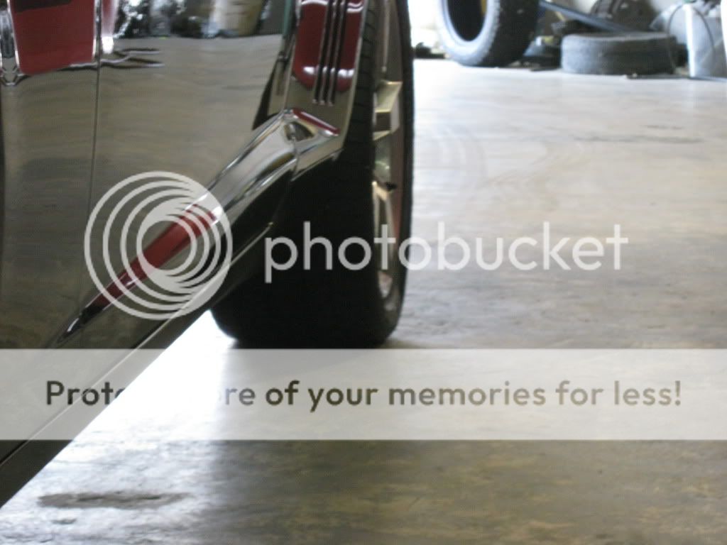

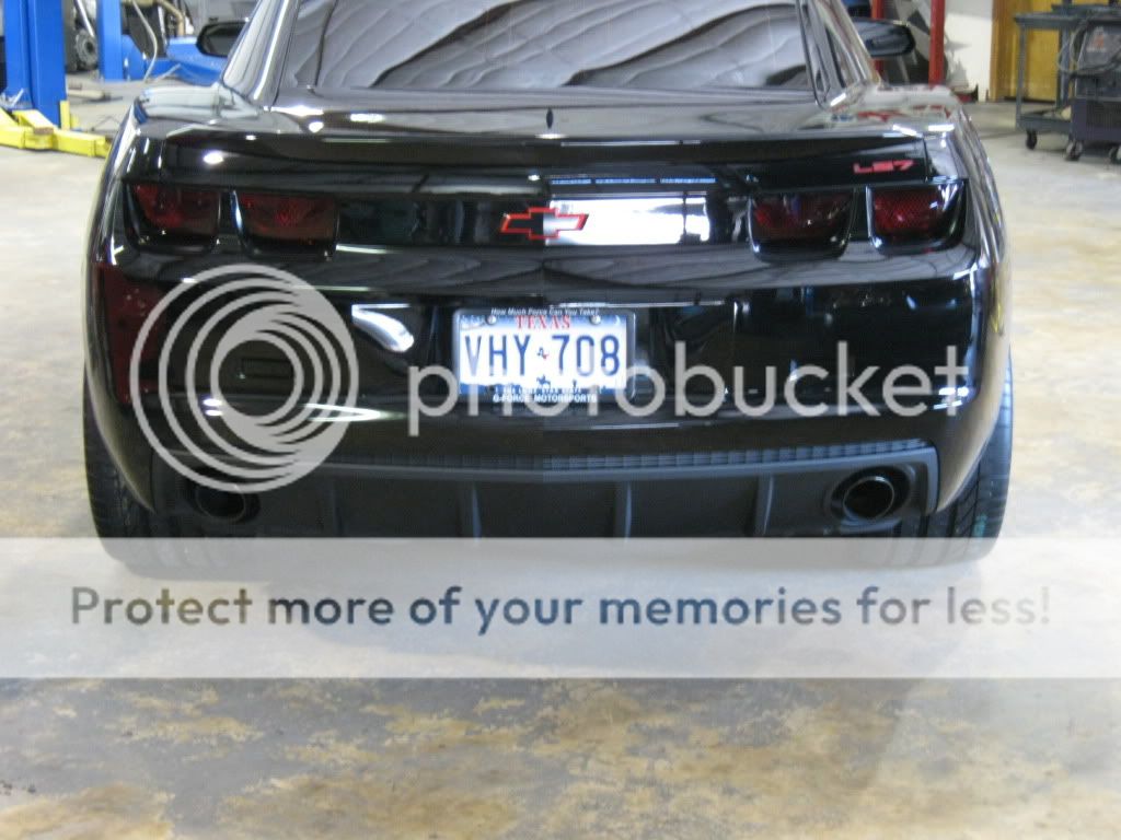

Pics 305/35/20 Pirelli PZERO on Stock Wheels
We just installed 305/35/20 Pirelli PZERO tires. They fit perfect!!!
Here are some pics.

Looks pretty good!

305 on a 9.5 inch rim? I personally would not push the limits.

305 on a 9.5inch rim is really pushing it. Plus it does nothing to help your contact patch.

305's on a 9.5" wheel? Definitely pushing it a bit but it looks awesome!
The recommended rim width is 10.5" to 11.5" for 305's, with 11" being ideal.
But the good news is that you just shaved 4lbs in tire weight off of each corner over the stock 275/40ZR20's. Stock is 36lbs per tire vs. 32lbs per tire for the 305/35ZR20's.
No rubbing on the inside during hard cornering?

I will post side shots in the morning. They do not looked stretched on the rim at all.

looks bad ass, little concerned over its limits though

is there ANY rub Lock to Lock?
