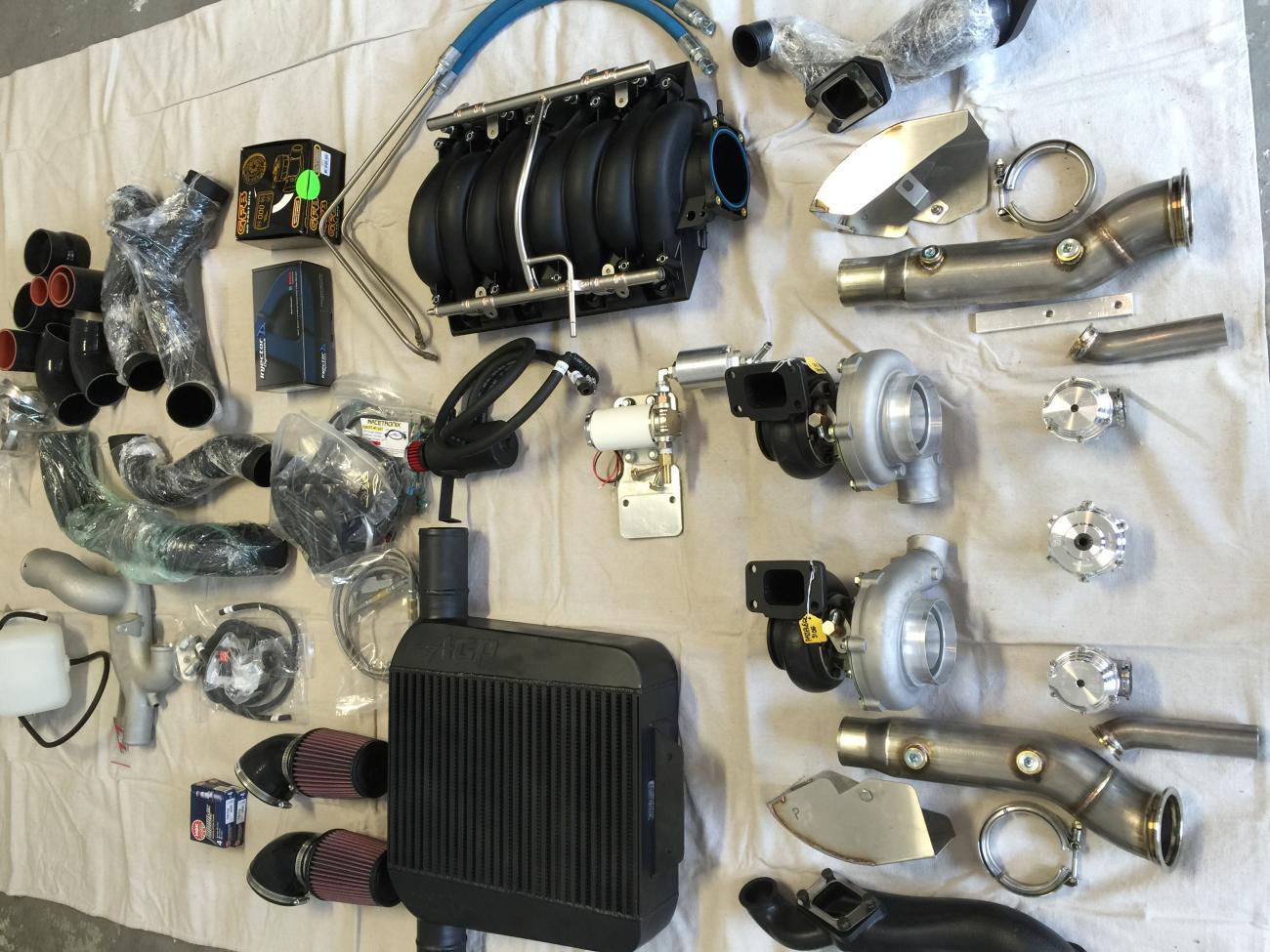

It's great to see some nice builds popping up the last few weeks. I figured I would start a thread showing alternative route to make the ZL1 an even better all around performance toy.
I dynoed my 2013 auto ZL1 on a mustang dyno bone stock and made 456 whp. This is pretty common from what I have seen.
The stage one build up will consist of a completely stock long block to see what gains can be had and then later for stage 2 a LSX build.
Part of my goal was to keep things in a budget that would compete with the standard pulley, cam, header, CAI, etc builds.
AGP turbo kit with BB Garrett turbos, good for 1000whp, auto cooler lines, powder coated piping, plugs, blow off valves, etc
New LS3 intake and fuel rails
ID1000 injectors
Go Fast Bits boost controller
Result and pics of the build up will be posted shortly.

Sorry for the completely noob question, but do they remove the Supercharger or keep it?
Dmpsix is offline   Reply With Quote
Old 03-24-2015, 03:18 PM   #11
Redlineviper
Redlineviper's Avatar
Drives: 2013 ZL1
Join Date: Jan 2015
Location: Orlando
Posts: 936
Jessrayo has tried to run a compound system with some success. But I think the general consciences is that removing the supercharger and running just twin turbos is the best option at this time.

Thanks for the compliments, I hope I didn't come off arrogant. I would stay away from the compound thing, all its done is lay down a big dyno number, hasn't impressed me on a track yet. Properly sized turbos are responsive & make crazy power, my car has shown that & it has never been ran at full boost.

Everything is here, time to start the conversion!
