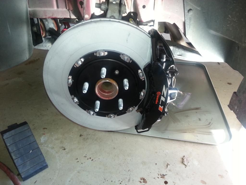

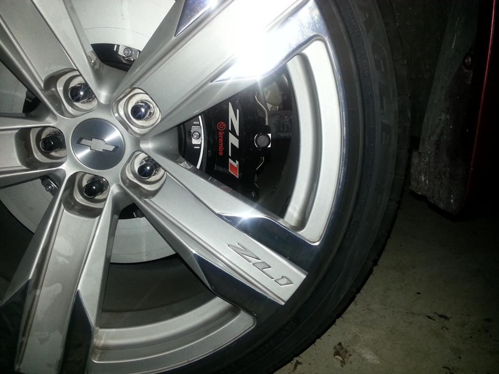

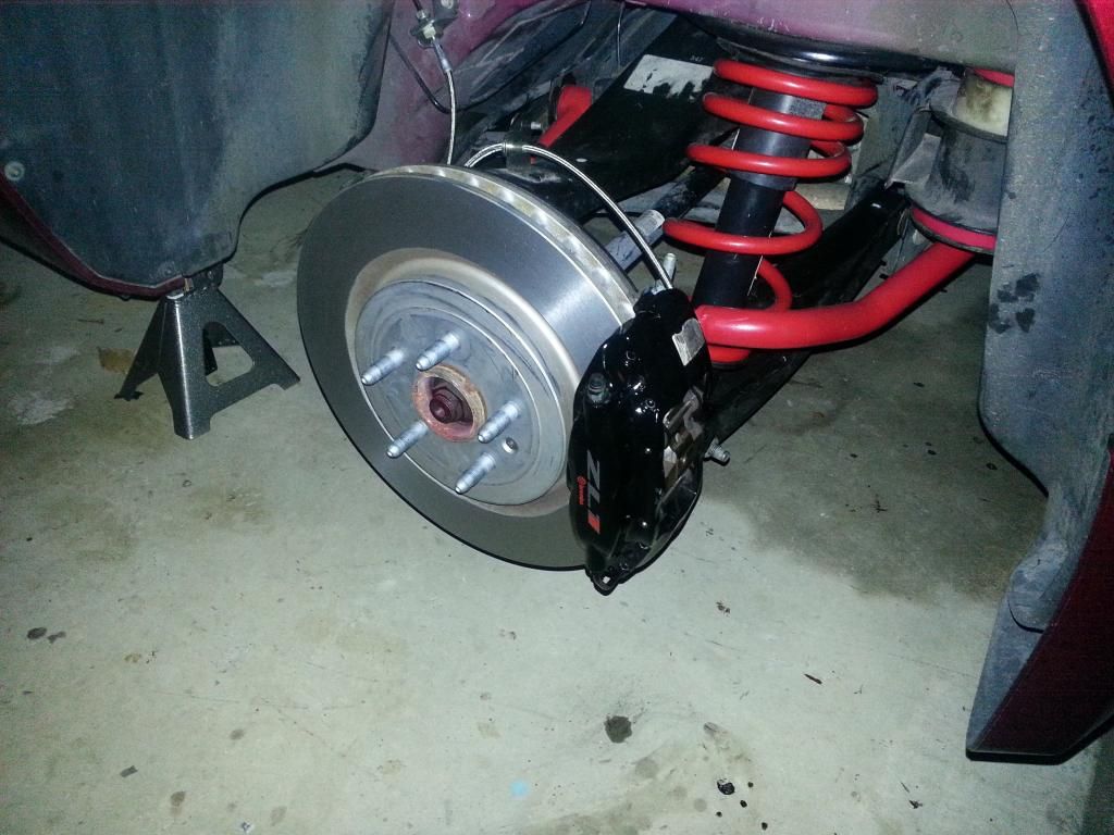

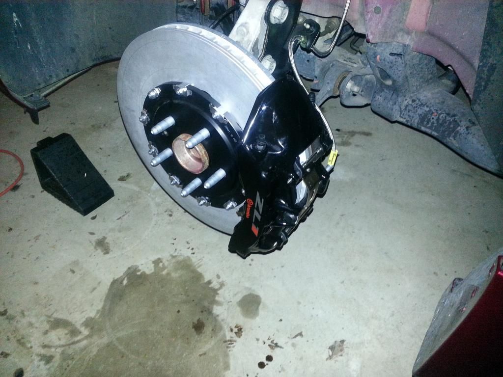

Nope, I have them on my car (installed them myself):
Notice the 'bleeder' location and how far away from the top it is -- pretty clear those appear to be 1LE (or 2SS repainted). Also, you MUST have the rotors too -- these are '2' piece on the front along with the backing shield:
The backs are the same as the 2SS excepted painted 'black':
You can show him (or her) these images -- clearly, that salesperson does not have any idea...
