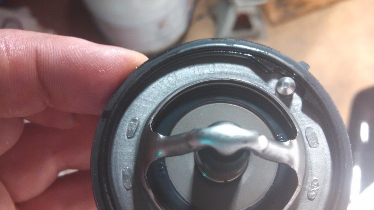

Posts: 6,824
Originally Posted by hammdo View Post
Yep, 70/30 and maybe a 160* thermostat too...
-Don
factory thermostat is a 160°F which is suprising

http://www.camaro5.com/forums/showthread.php?t=409726

Wow, didn't expect that. Thanks I didn't know that one!
