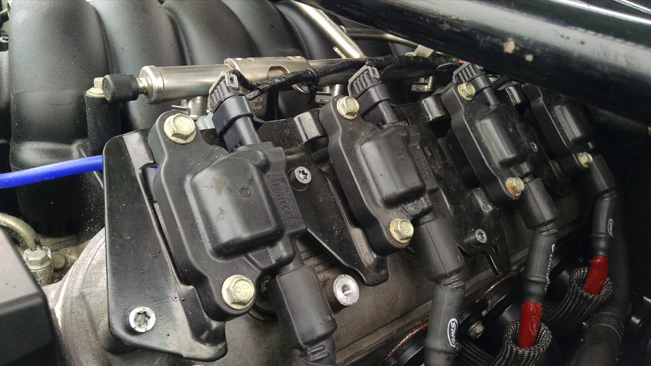

Are there good lightweight billet coil brackets for the 72mm coils?
I want to get rid of the stock ugly and heavy coil brackets.

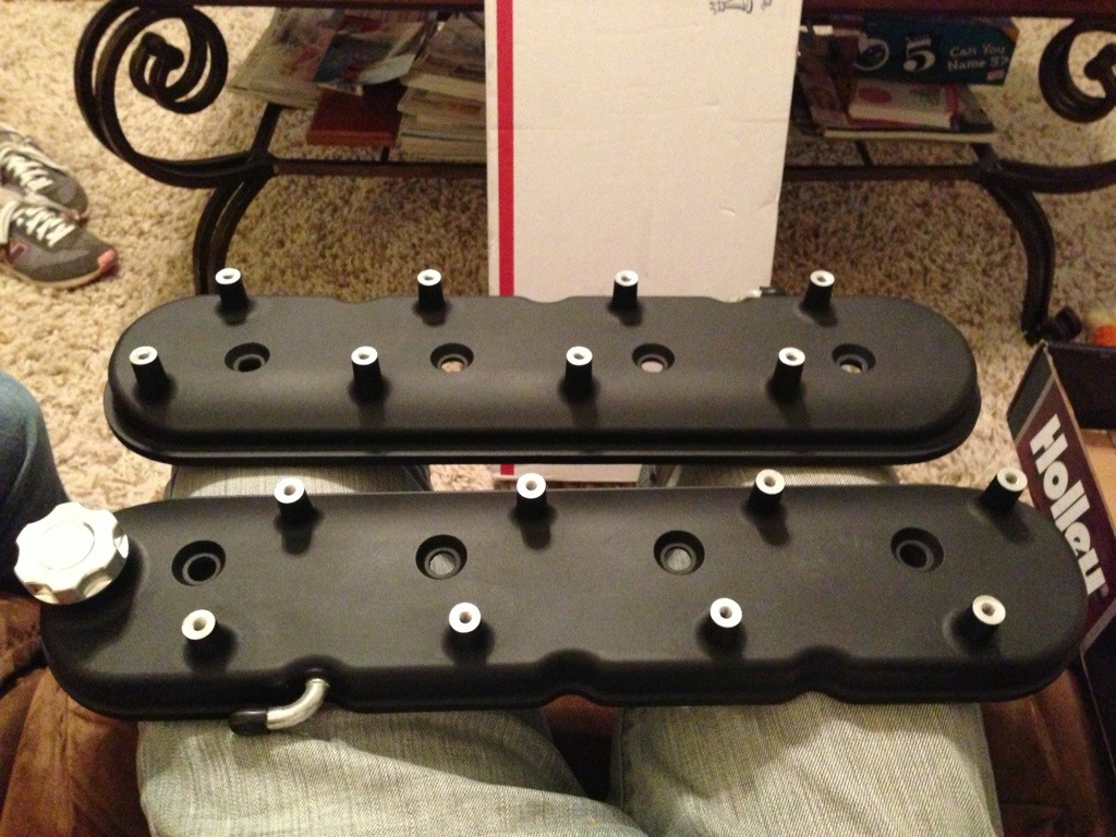

Another option I looked at is getting the Holley valve covers and eliminating the brackets altogether.
Does anyone know how they compare weight wise?

I would imagine that eliminating brackets and using the holley covers would be lighter, I have seen a lot of pics of the holley covers and they do look nice.

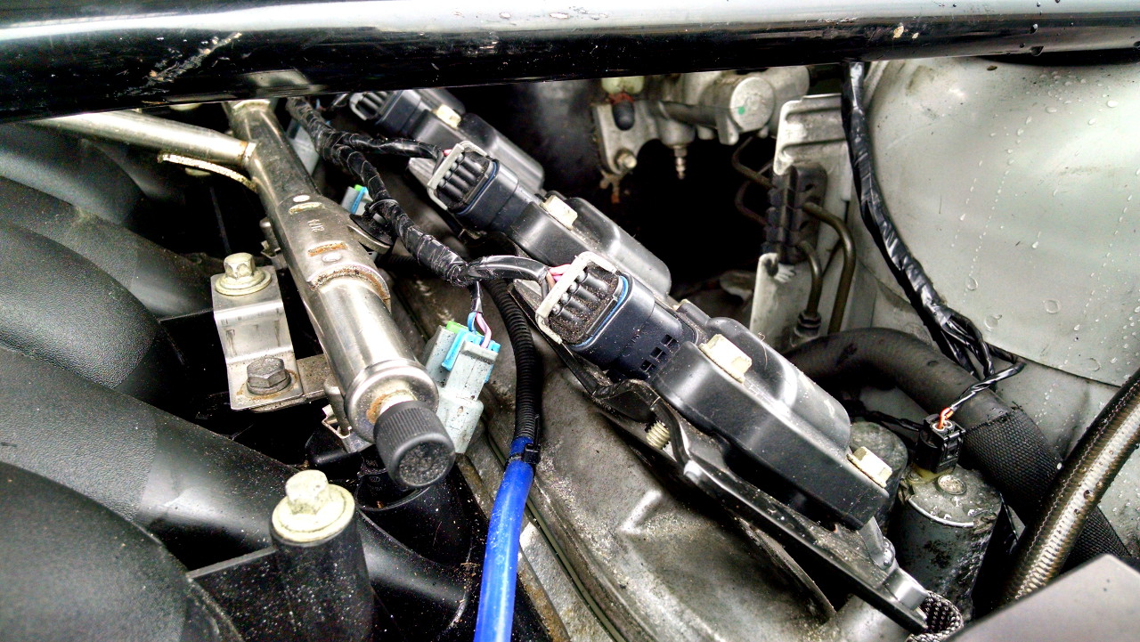

I would like to keep the coils in the stock location though.
I made my wiring harness very tight and I'd have to modify it for those brackets (same problem with the Holley covers, that's why I'm holding off on pulling the trigger). Definitely putting it on my list of possibilities though.

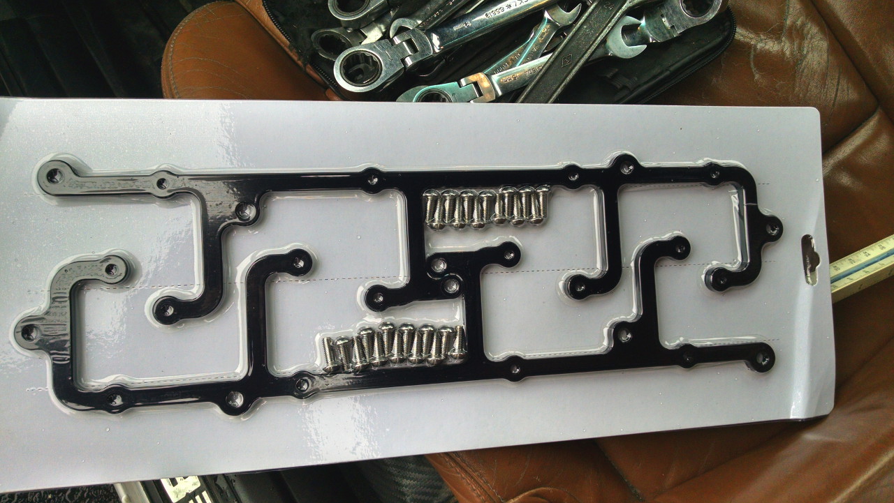

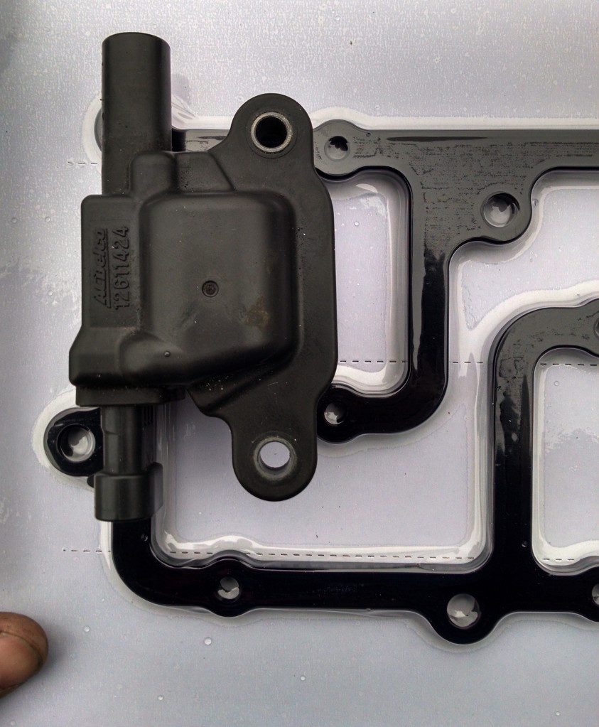

OK, so I got these brackets, they came in today. They look pretty, but not even close to fitting.
The LS2/LS3/LS7 coil bolt spacing is 72mm, the LS1/LS6 coil bolt spacing is 65mm.
Not sure how they fit the valve coves because I didn't take them out of the packaging.
Expensive lesson. I hope I can find someone to buy these off of me...
So... Still on the look out for mounts.

I already have something similar. I made the whole harness form scratch and the coil plugs are taped close to the injector plugs. I left some slack, but not much and I don't know if it'll be enough to reach re-located coils without modifying the harness.

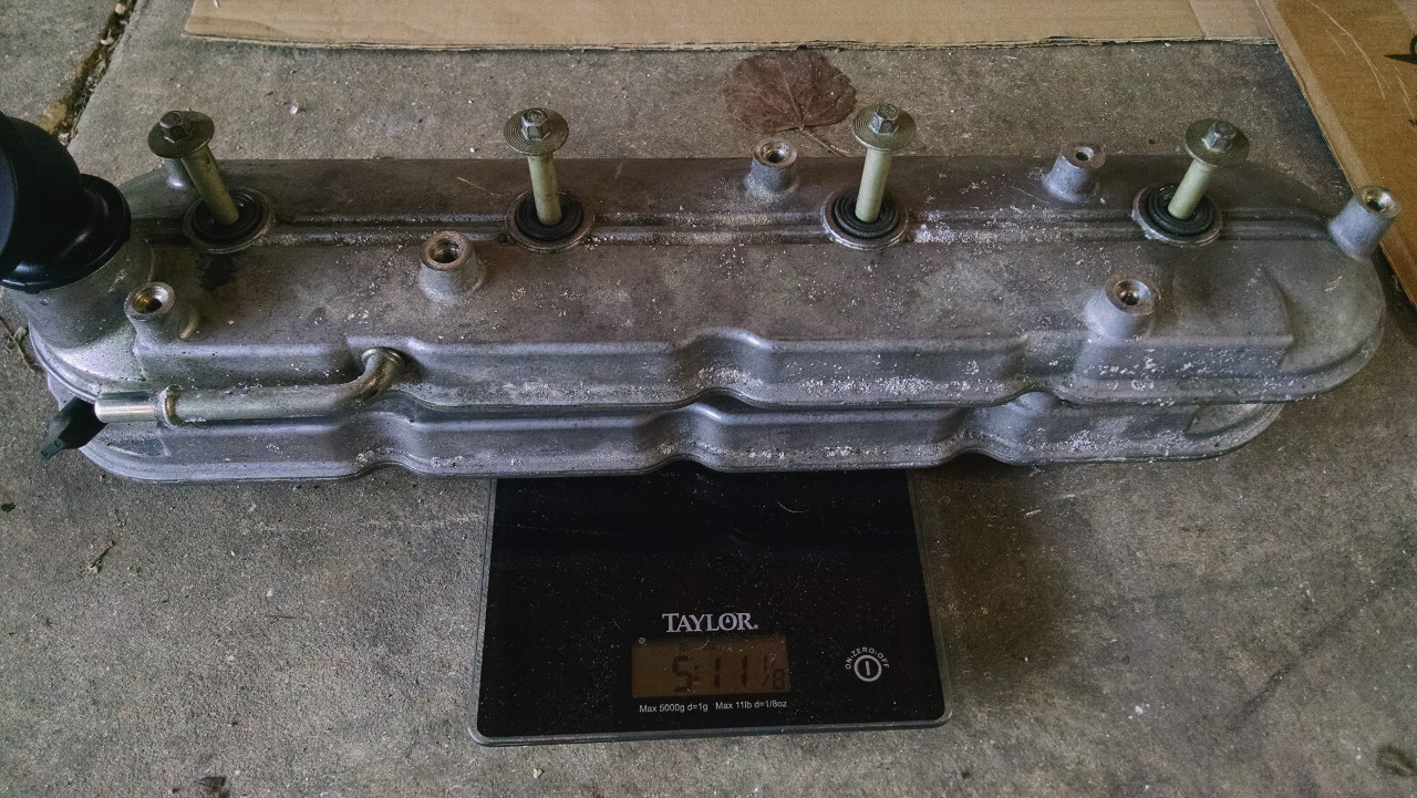

Also, the stock valve covers weigh in at 5.7lbs with bolts and gaskets.
The Holley covers are listed at 6.8lbs with no hardware, so since I'm trying to do this to make things lighter, they are out of the equation.
