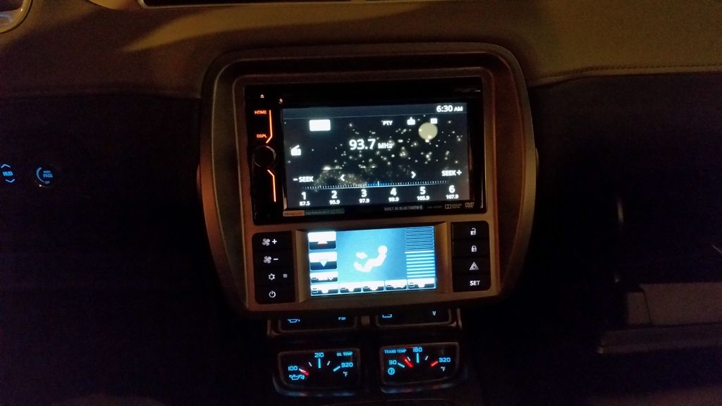

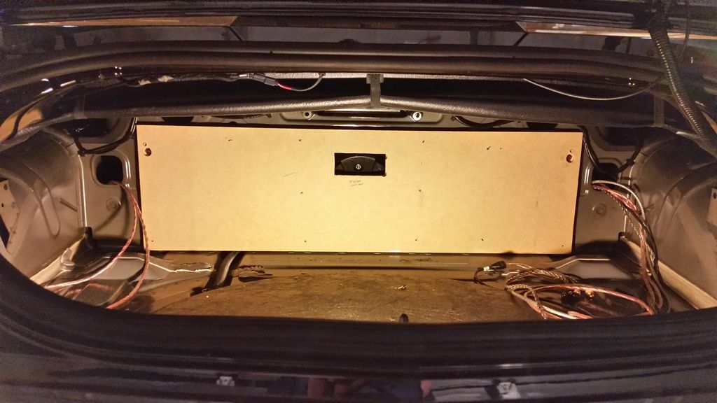

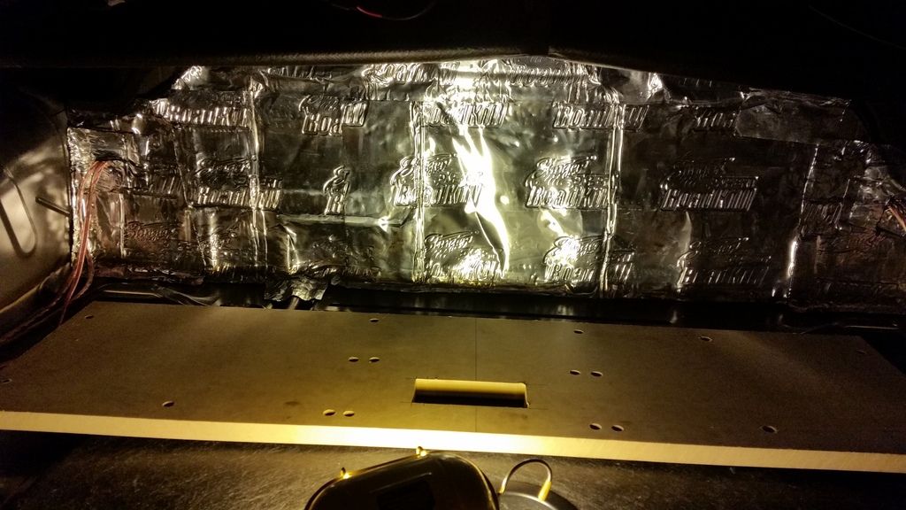

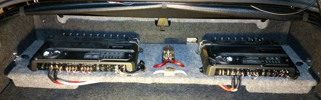

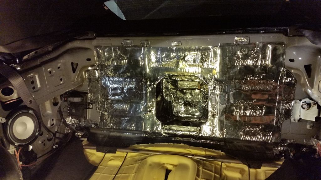

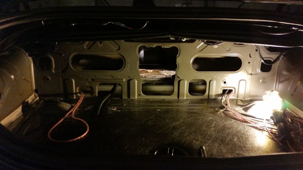

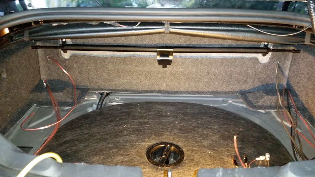

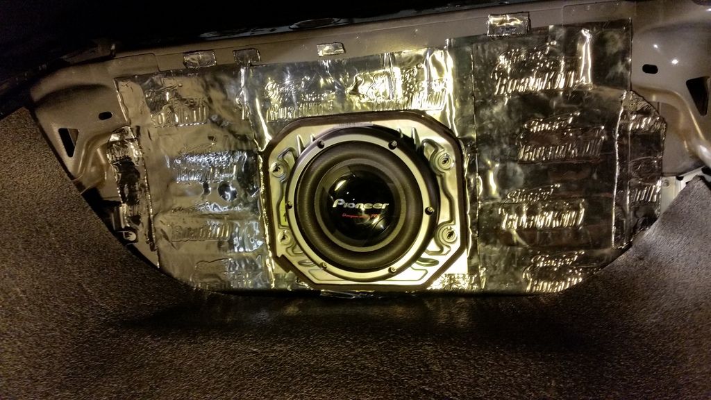

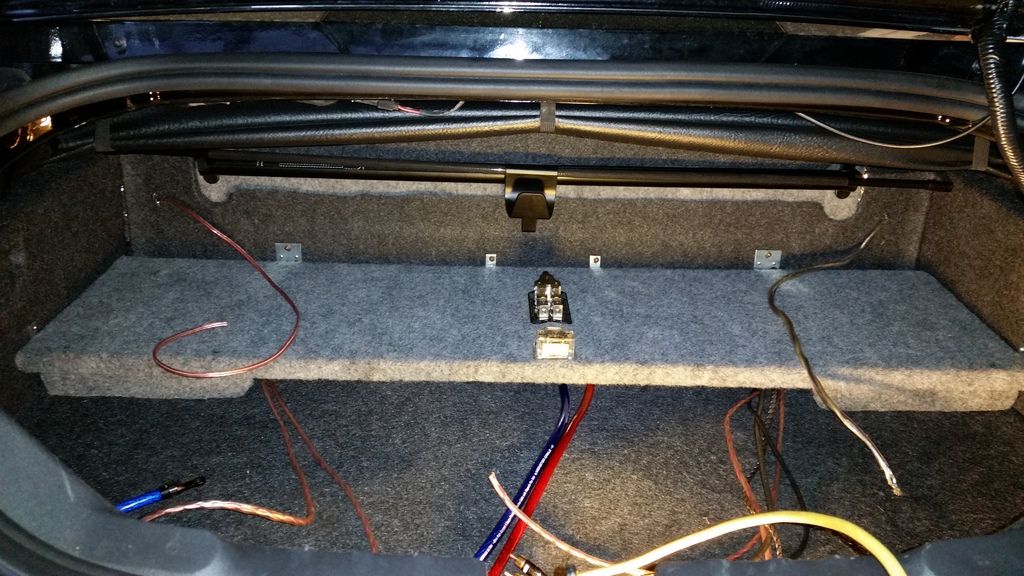

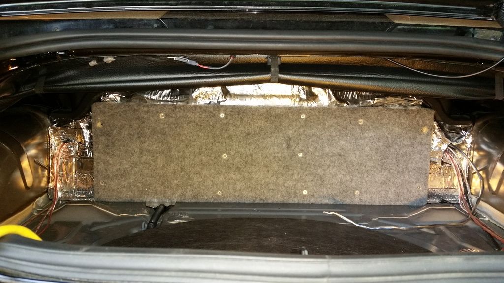

Here is what I did:
This platform sits roughly 3 inches below the luggage screen and has hinges in the rear to lift up and access the wheel well below.
Kenwood Excelon 4Ch & Sub Amp
Reinforced the existing sub "box" with deadening material.
Pioneer TS-W2502D4 10" 3000 Watts 4 Ohm DVC
I'll be starting a mod thread in the journal section of the forums here soon to show everything I did. This project took the whole summer a few years ago.

Does that single sub hit pretty hard? That is where I am still stuck - whether or not to replace the stock with a better sub or go with a separate box in the trunk. I would prefer to stick with the stock location because I use my entire trunk frequently. Nervous about how it would sound though. Was the stock location deep enough?

Yes it hits hard. Due to the lack of space, I decided to get the largest 10" sub I could find. It was a fairly decent deal at the time. However, the stock location was too shallow, so I had to modify the trunk wall some.
