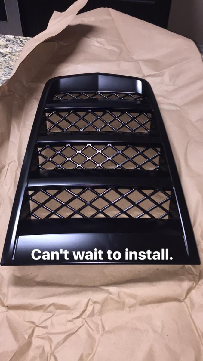

Has anyone seen this in carbon fiber or know where i could get it laid? not hydrodipped. I just received mine today and thought it would look great in CF. I got a quote to get it laid for $1000
