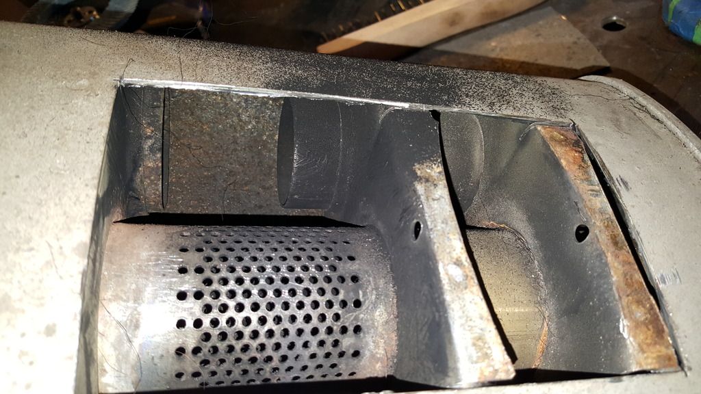

Did this a couple of weeks back. Love the sound. Definitely louder from stock, and snap crackles and pops a lot more. Getting headers put in this Saturday, amd possibly a cam next week. Til then.. Enjoy, and heres the inside pics of the muffler....

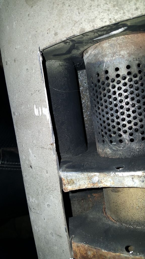

Looks like that perforated pipe that is cut-out is replaced by a solid one?

Yes, cut and replace. Ill be un bartlett area tomorrow.. lunch time.

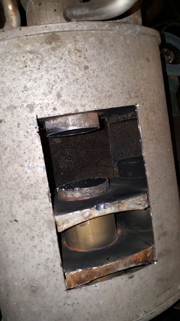

When the dual-mode flap/valve is in the fully open position isn't that center pipe already straight through the muffler from one end to the other without interference?
How does removing the straight through section that has the holes in it make much difference in the sound level when the valve is open?
Not understanding how this would alter the sound much? Does it instead send some sound out the other pipe tip on the right side (top of photo).
When the flap/valve is SHUT I can see how this mod would be louder. But when valve is open does it really make much difference?
OP BEFORE
OP AFTER

Yes. Having the valve open will jave a straight through sound... i keep it open. With the perforated pipe sealed, itll be more of a straight pipe with the option to quiet it down.
