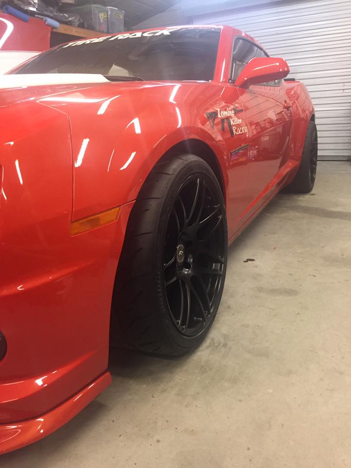

Offset could also be determined by the style of wheel you select. I am currently running a 19x11 upfront with no rubbing at all so it is possible. I am also on 1" lowering springs and running camber plates to gain the negative camber I want. Now the 305s do still poke out some but since I don't use them as my DD it's no big deal for me. Although my local tire installer did cuss when he tried to mount them, I did go with a 30 series tires.
How much camber are you running? How far do they stick out? Thanks for the picture
