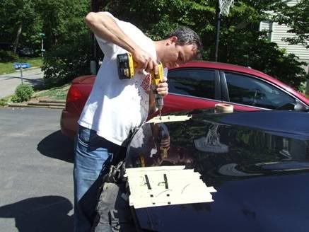

I installed the NLP spoiler on my non-rs 2lt and they supplied a template.
If your spoiler uses the factory mounting holes I would remove the 4 rubber plugs from the underside of the trunk lid (2 each side) They are the location for the factory mounting. I would carefully center a pilot bit and drill up thru the lid, this will give you the 4 outer bolt locations.
From there I think you could measure to the 2 center bolt locations and drill down. You need to remove 4 plastic fasteners and trunk latch cover to pull down the felt lid liner to get to these from the under side.
I drilled with no problems.

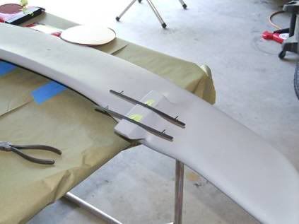

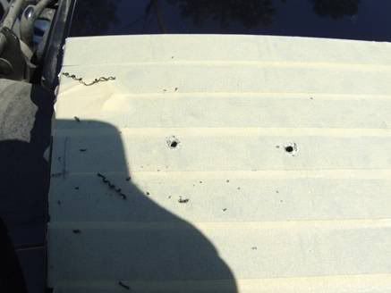

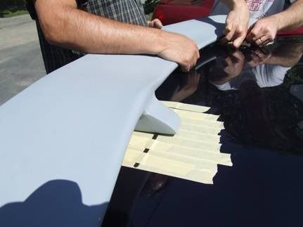

Normally if a vehicle doesn't have the OEM holes already from an excisting spoiler the manufacture should supply T-straps. The T-straps are inserted into the holes on the spoiler and have two ends that you would tape to the car while prefitting the spoiler in place. After you tape them to the car, you remove the spoiler and the t-straps mark where the hole needs to be drilled. it's harder to expalin, so I'll try to put up a picture for you.
