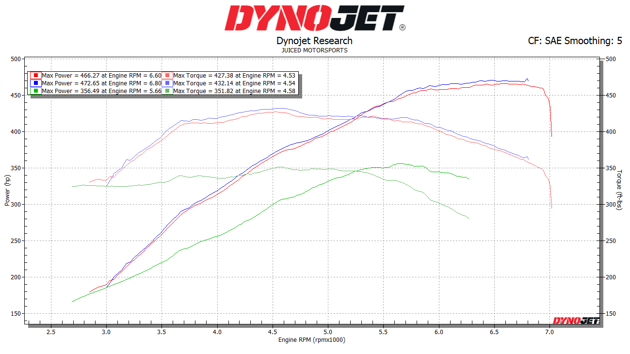

Here’s mine, SS4 with 6 speed
GPI Powered
Bluebagger06 is offline   Reply With Quote
