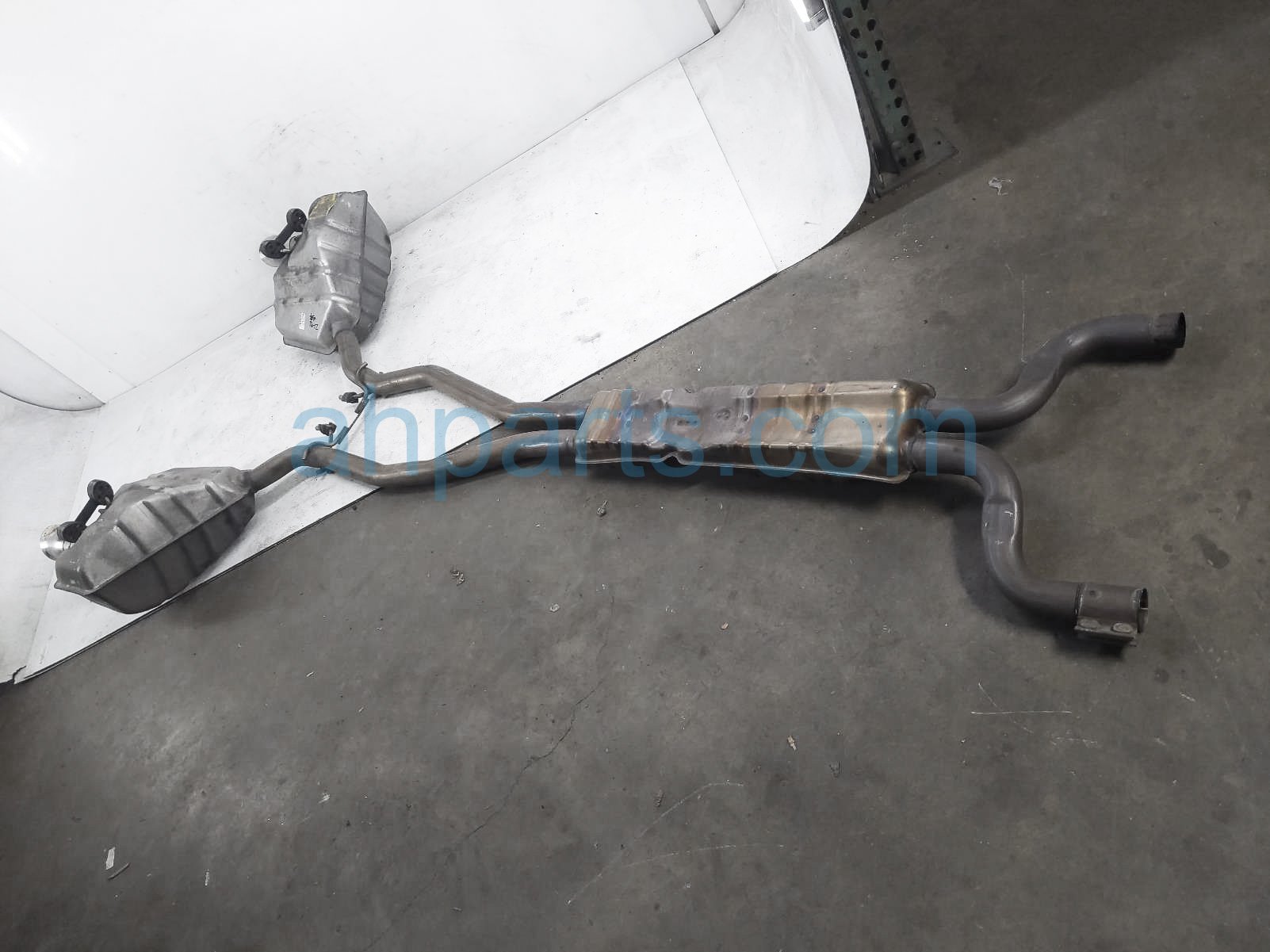

I'm looking at a pic of the factory exhaust for a 2015 SS auto and I'm not seeing that part at all.
