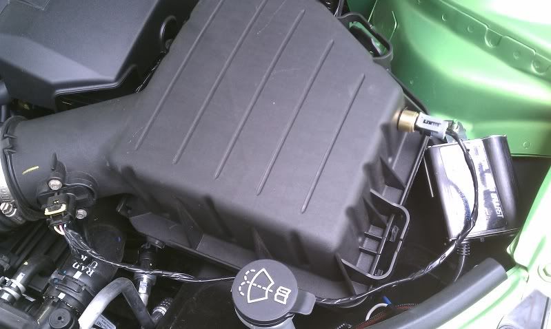

Did the air relocation mod....
VERY NICE!! Takes about 20 minutes and has a difficulty level of about 1. Used Scrming's thread with all the parts and pics. Got in for a quick test drive and the difference is def noticeable... it maintains that quick response the whole time. Usually after a few hard runs, you can feel the lag... not anymore!!
Here's the pic, doesn't even look too out of place!
Very cool!!! (ok.. pun intended! LOL)

Posts: 100
After doing this I got an engine light and I couldn't figure why.... but if you look at my pic carefully, you will see I cut the wires and attached the new sensor to the old one instead of the wires running to the ECM. So in essence, I drove about 60 miles with no sensor
So 2 questions...
#1 did I do any damage by doing this?
#2 will my engine light go off as the car cycles a few times or does it need to be cleared and reset?
No wonder it was so fast... air temp 0

Posts: 7,745
So 2 questions...
You didn't hurt anything....
Not sure if it will clear...
scrming is offline   Reply With Quote
