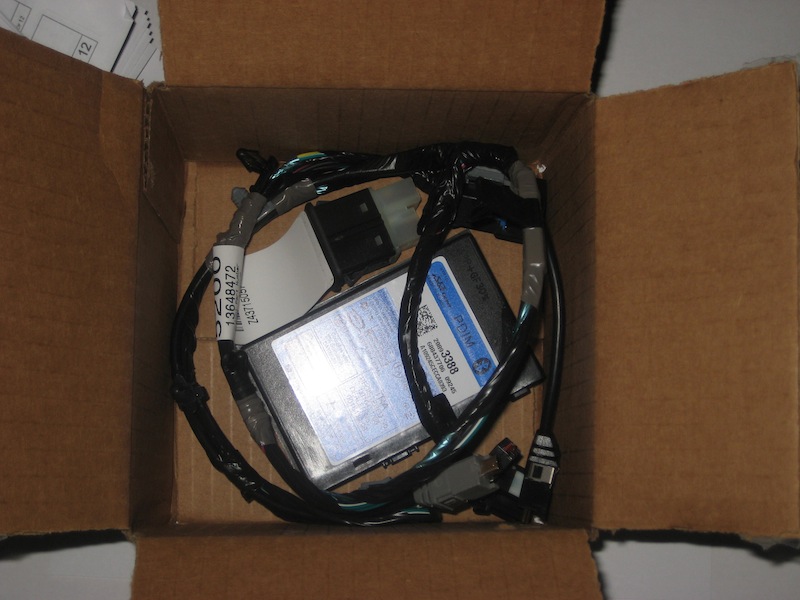

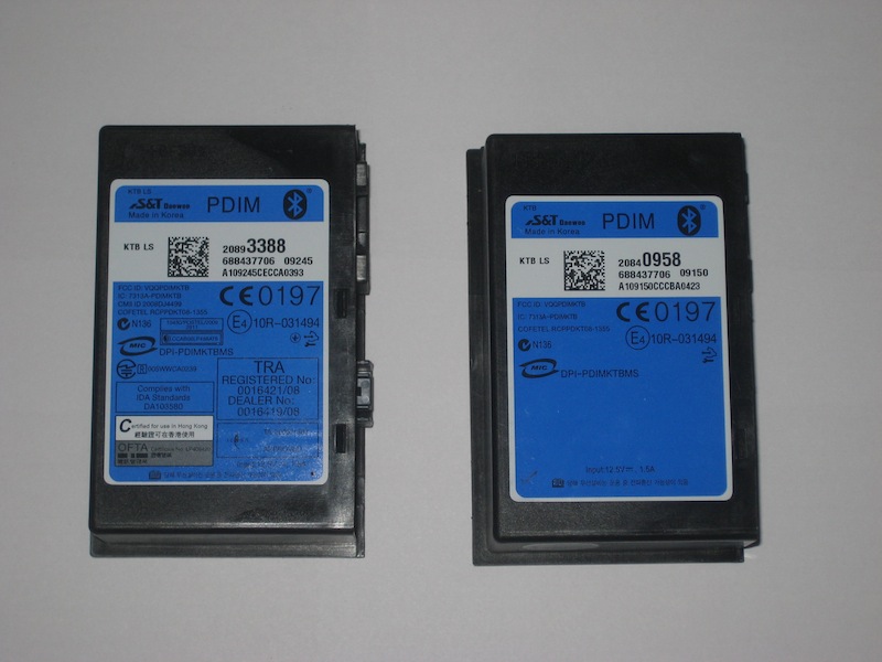

I just got the PDIM today (#92244580). As you can see it comes with the harness that is needed to connect the PDIM. There's no way I could I have made this harness to install the PDIM I bought off ebay (http://www.camaro5.com/forums/showthread.php?t=43733). I also grabbed a picture of the PDIM accessory vs. a PDIM pulled from a 2SS. I plan to install it either tonight or tomorrow.

So they are different, I suspect one has bluetooth and the other doesn't....
No, they are the same. The model number is the same (which almost guarantees it) and the FCC ID is the same (which completely guarantees it). You can see the bluetooth logo on the top right corner so it definitely has bluetooth as well (in addition to the FCC ID guaranteeing it).

I stand corrected, now will you also be able to pair your cell with the system?

also what are the two different #'s? (3388, 0958) initially I thought they were part #'s

Well it looks like this might not be a DIY after all. I reviewed the install instructions and it states that the radio needs to be programmed by a Service Programming System (SPS-TIS2WEB or equivalent).
17. Perform the radio calibration upgrade. This will allow the radio to recognise the PDIM. This is required on all vehicles that have not had the PDIM installed before.
18. Perform a PDIM calibration upgrade. This will ensure the PDIM has the latest level of software available.
Based on the PDIM Software Update thread, not all dealers know how to do this :(
I'm going to install and see what happens when I power it up.
You will be able to do A2DP streaming for music. You will not be able to use it for hands free calling.
Not sure what those numbers are, they very well may be "part numbers". But the actual item is the KTB LS. From the FCC info, there's a KTB LS and KTB MS. I don't know what the difference is except for a chip in a slightly different place on one and an added component connected to that chip.
Maybe someone who has the PDIM out of their car could take it apart and tell me what the numbers on that chip are? Maybe the KTB MS is the one with more ram that could (with the right software) go past the 2500 song limit? Although the chip doesn't look like your typical ram chip. Not sure what it is.
