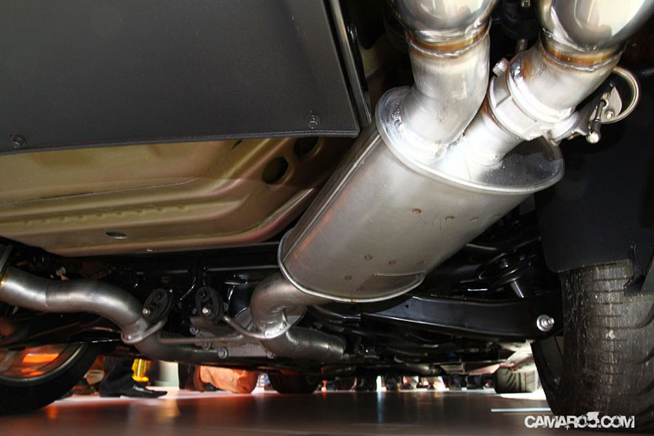

  • Cast stainless steel exhaust manifolds for enhanced thermal management
  • Active exhaust (with dual modes - similar to Corvette ZR1 & Z06)

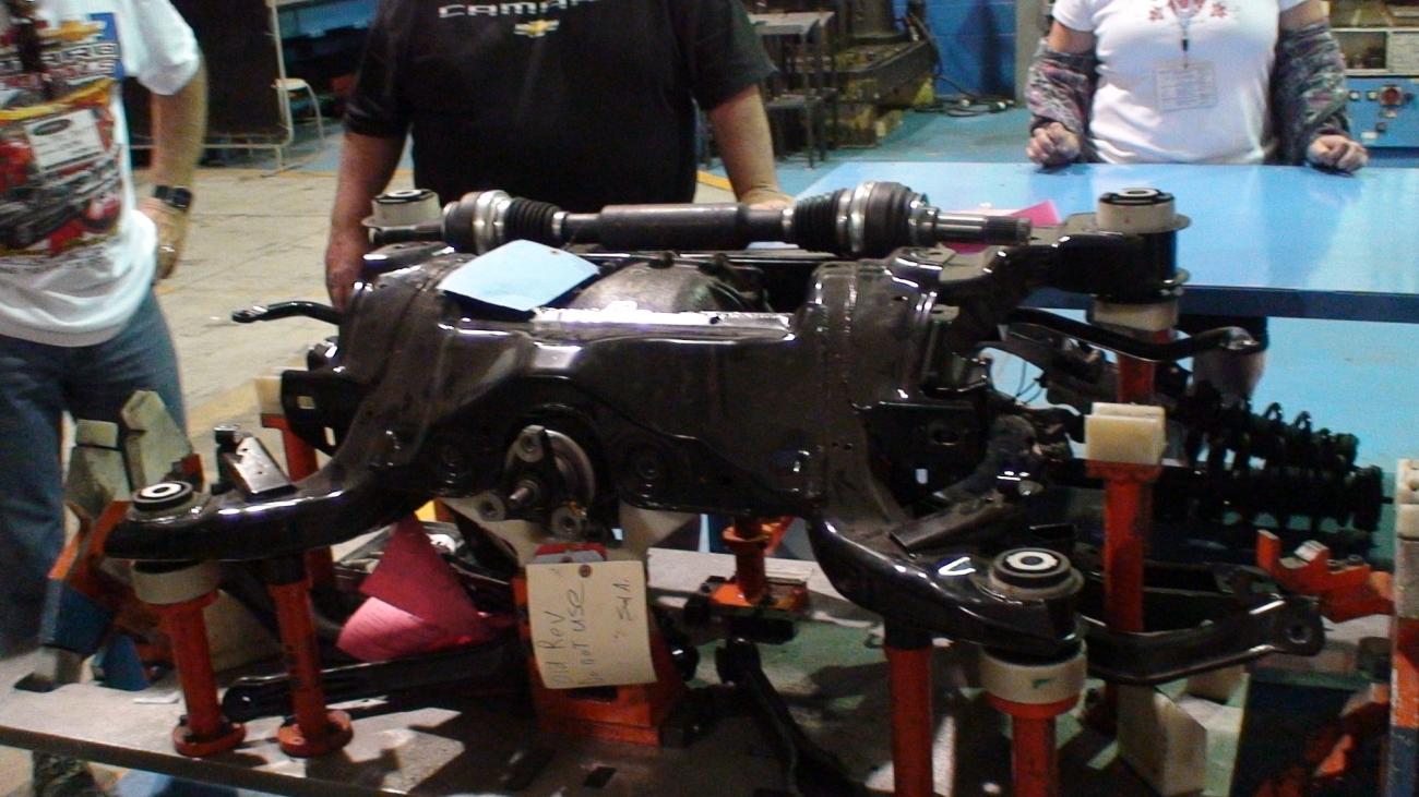

  • Upgraded 6L90E 6-speed automatic transmission (MYD) has been enhanced with strengthened input gearsets, two additional planetary gears, an additional clutch plate, and strengthened output shaft

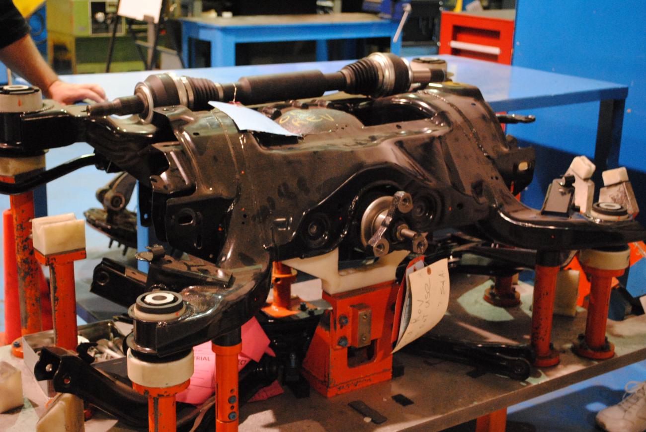

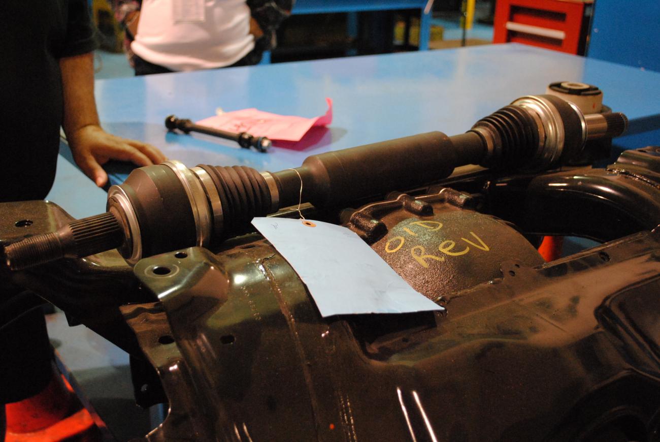

  • Upgraded driveshaft
  • Upgraded limited-slip differential, featuring race-ready cast iron diff' housing, clutch packs and axle shafts (patent pending)
  • Upgraded cradle bushings

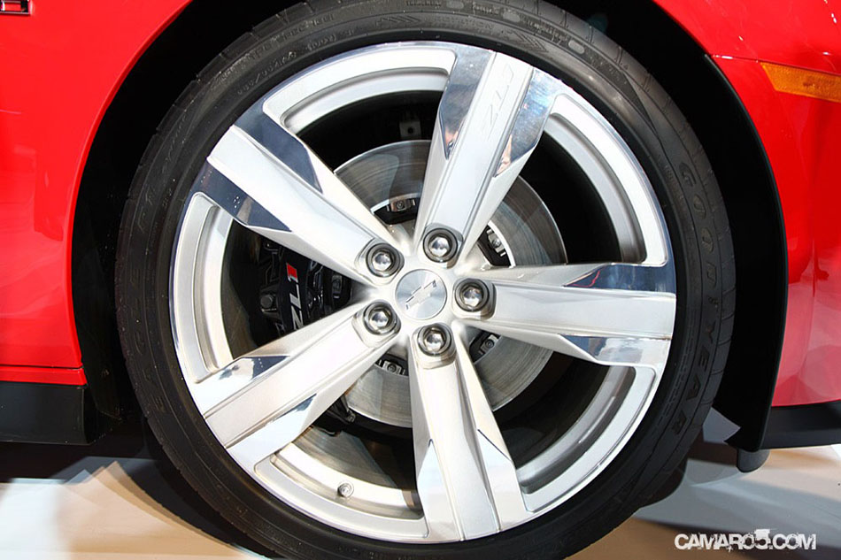

  • Brembo brakes - Front : 6-piston 14.6" 2 piece rotors / Rear: 4-piston 14.4" rotors
  • Light weight forged aluminum wheels - F: 20"x10" / R: 20"x11"
  • 10-Spoke black low-gloss "SSX"-style wheels (standard and optional wheels are 11-pounds lighter than SS wheels)

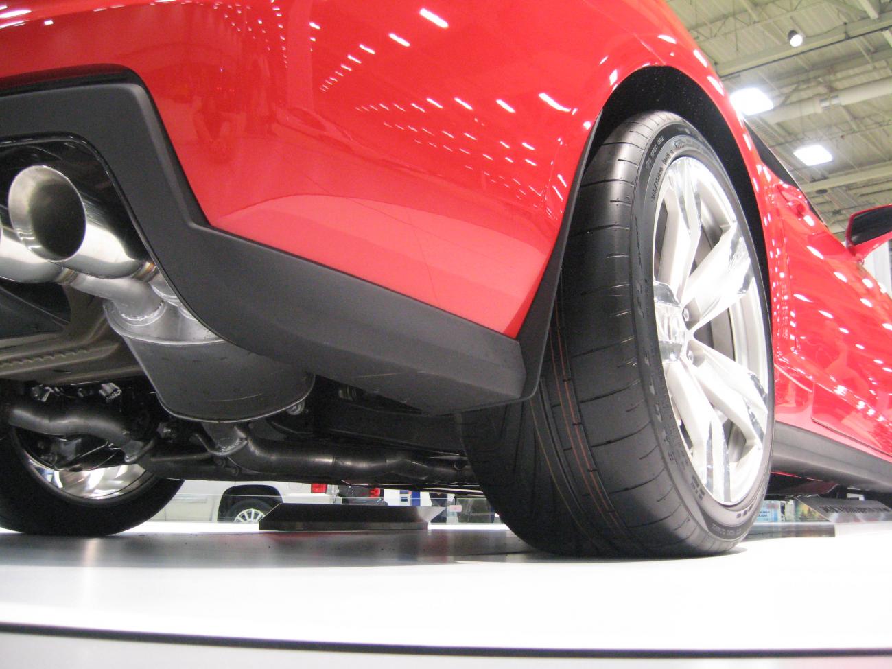

  • Goodyear Supercar F1:G2 tires - F: 285/35/20 / R: 305/35/20 (specific to ZL1 and lighter than SS wheels by 11 pounds per car)

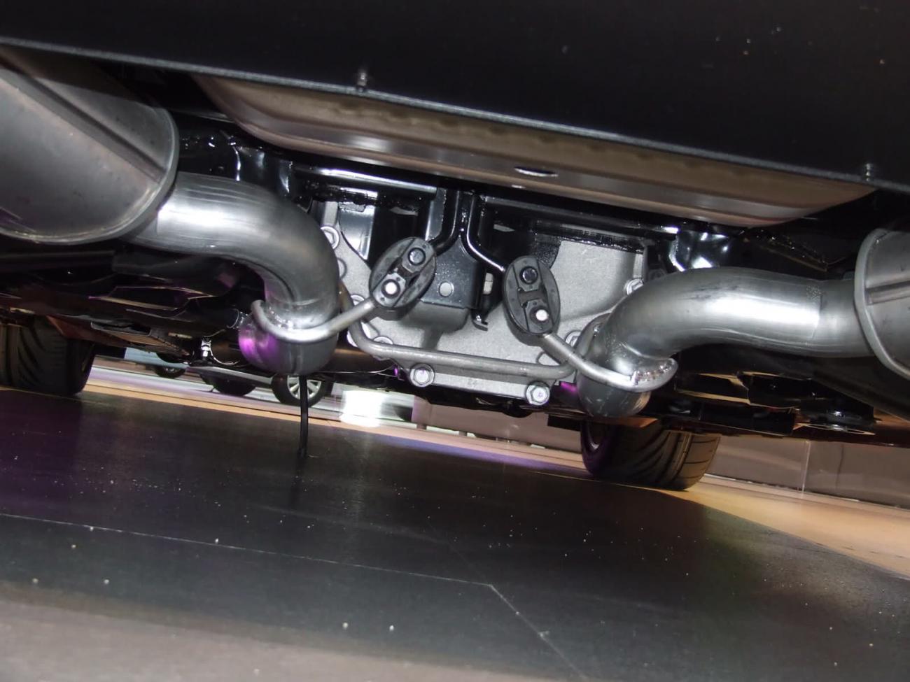

  • Functional front lower splitter and underbody tray
  • Front fender wheel opening and rear facia air deflectors manage air flow around the wheels and tires

  • Quad stainless steel exhaust tips

Dual-Mode Exhaust:
The dual-mode exhaust of the ZL1 provides refined tuning (optimal noise and vibration characteristics) at low engine speeds and a low-restriction exhaust (enabling peak horsepower performance) at high engine speeds in one exhaust system. It utilizes a vacuum system similar to Corvette, coupled with twin valves located at the exhaust tailpipes.
Although both Corvette and Camaro use vacuum actuated exhaust valves, there are differences. In the Camaro, the control software resides in the chassis control module that contains other software, to reduce the number of modules in the vehicle.
The Corvette is calibrated to open the exhaust valves only during aggressive driving, when engine rpm and throttle position exceed certain values. The Camaro is also calibrated to be open during aggressive driving. In addition, it is calibrated to open the valves at engine idle and up to 1,000 rpm.

Brembo® Brakes
The ZL1 is equipped with a large, extremely robust, Brembo brake system (Fig. 4) with 6-piston front and 4-piston rear calipers and ventilated two-piece front and one-piece rear rotors.
TIP:
Due to the floating design of the brake rotor, the front brake rotor cannot be refinished. If the front brake rotor is found to be at or below the minimum specification, it must be replaced.
TIP:
The Goodyear Eagle® F1 Supercar® Generation 2 (G:2) tires have been developed and optimized specifically for the ZL1 to yield outstanding handling while maintaining requisite street-tire performance for wet handling, tread wear, noise, mass and rolling resistance.
It is not recommended to use the high-performance summer tires when temperatures drop to approximately 40 degrees F (5 degrees C) or below. It is recommended these tires be stored indoors at temperatures above 20 degrees F (-7 degrees C) when not in use.
The ZL1 tires should not be rotated. They are corner specific by design. These tires are unique in their wear patterns. The outside shoulder may appear worn as compared to other tires.
Underbody Belly Pan
The ZL1 underbody incorporates a belly pan that helps reduce front lift. The shape was enhanced to draw air upward into the underbody area. This highly energized air provides extra cooling for underbody components affected by the additional exhaust thermal energy of the high-powered LSA engine.
The underbody belly pan will need to be removed before performing service work, including oil and filter changes.

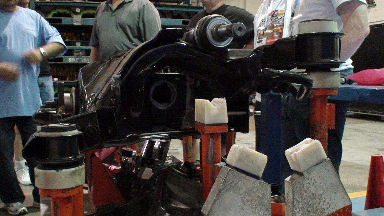

Some pictures of the features GM has outlined, many shared by Community members:
1-19 -- Camaro5
20 -- GM
21-23 -- Camaro5
24 -- BeckyD@RodgersChevrolet
25 - 29 --Z28RockStar
30 -- comm17
31 - 33 -- TLSTWIN
34 -- mclark10
35 -- TLSTWIN
36 - 37 -- mclark10
38-41 -- misc'

I appreciate the pics of the undercarriage. Is that a grounding strap hanging down in that one pic?

I didn't notice that before After looking at that picture more, I don't think it was taken on the stage, because I see another car in the background. That strap is nowhere to be found in the rest of the pictures on the stage.
Hmm...
