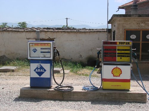

Avec la Step 3?
If you have been reading my posts in the multiple "what Octane" threads than you may have drawn this conclusion... for those who have not. I will spell it out clearly.
This is important to know and understand:
Just because you religiously pump from the "93 Octane Premium Handle" does not mean you are getting a full tank of "93 Octane Premium Gas"
I will explain:
Modern up to date Fuel/Petrol Stations are manifolded. The three gasoline grades are in separate tanks typically 85,88 and 90/93. However at some point they come into a common line.
If you use a pump like either below you are probably getting exactly what you intend to.
Notice: Separate handle and hose for each grade.
If you use one that looks like this one below.. Which most of us do, your first gallon or so could be 85 octane if someone filled up a gas can for a lawn mower before you got there.
Note: All grades same handle, same common line.
A 1.751 I.D. hose holds .1251 gal/ft....... Typical gas pump hose is say 10 feet (The length you can see).. so in the picture above in just the 10 ft of black hose you can see, is 1.251 gallons of 85 octane waiting for your car....... Even if you selected 93 octane.
So if you wonder why you have to do a fuse pull every now and then, this is why.....
You have two options for resolution.
  1. Find a gas station that has the older style Gas pumps.
  2. Camp your gas station and fill up behind someone who has just pumped premium.
