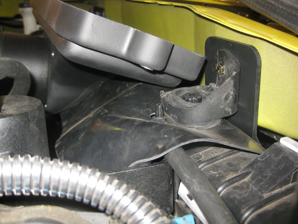

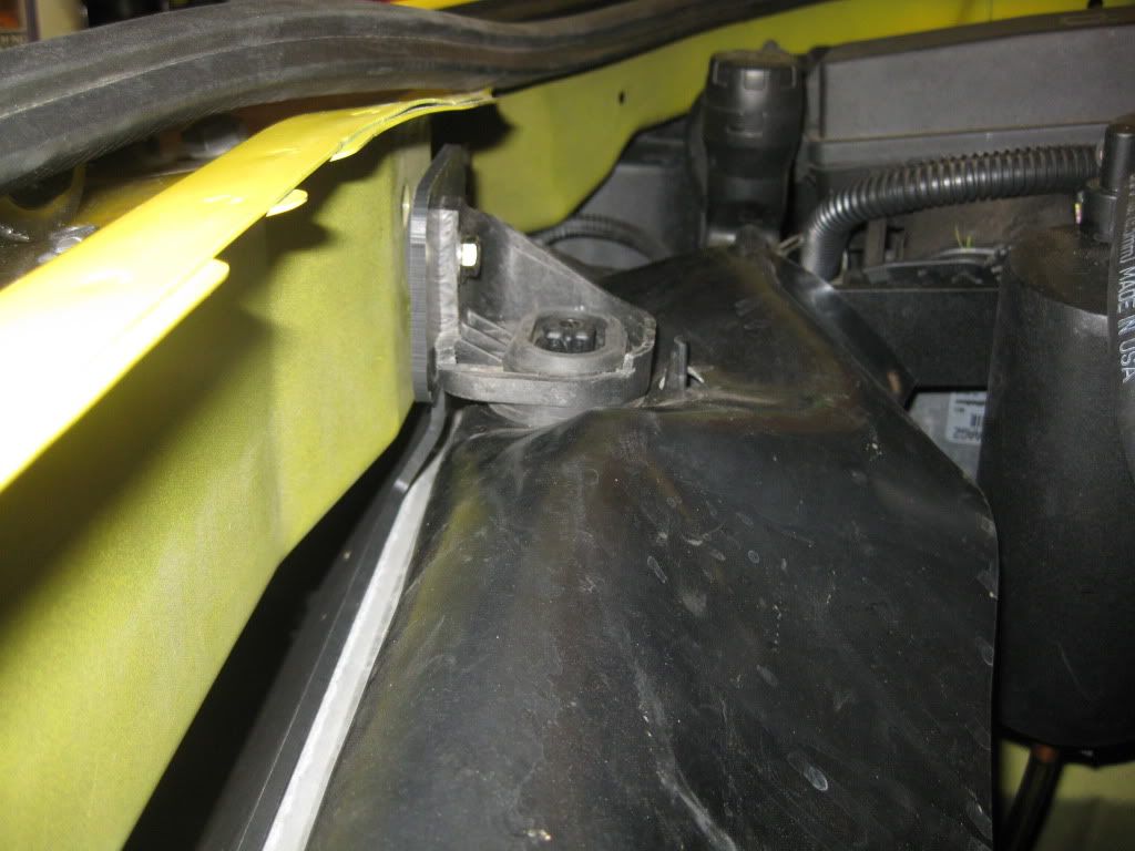

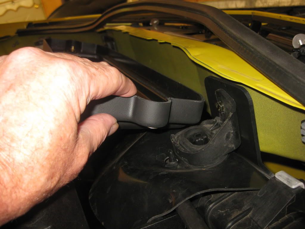

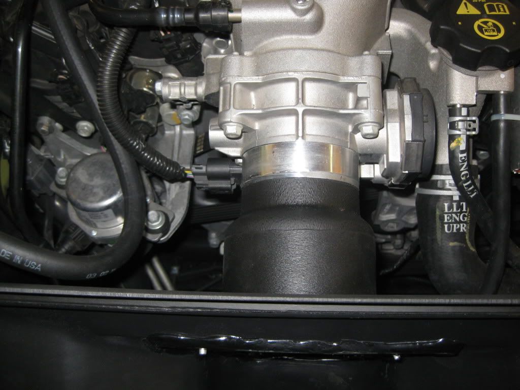

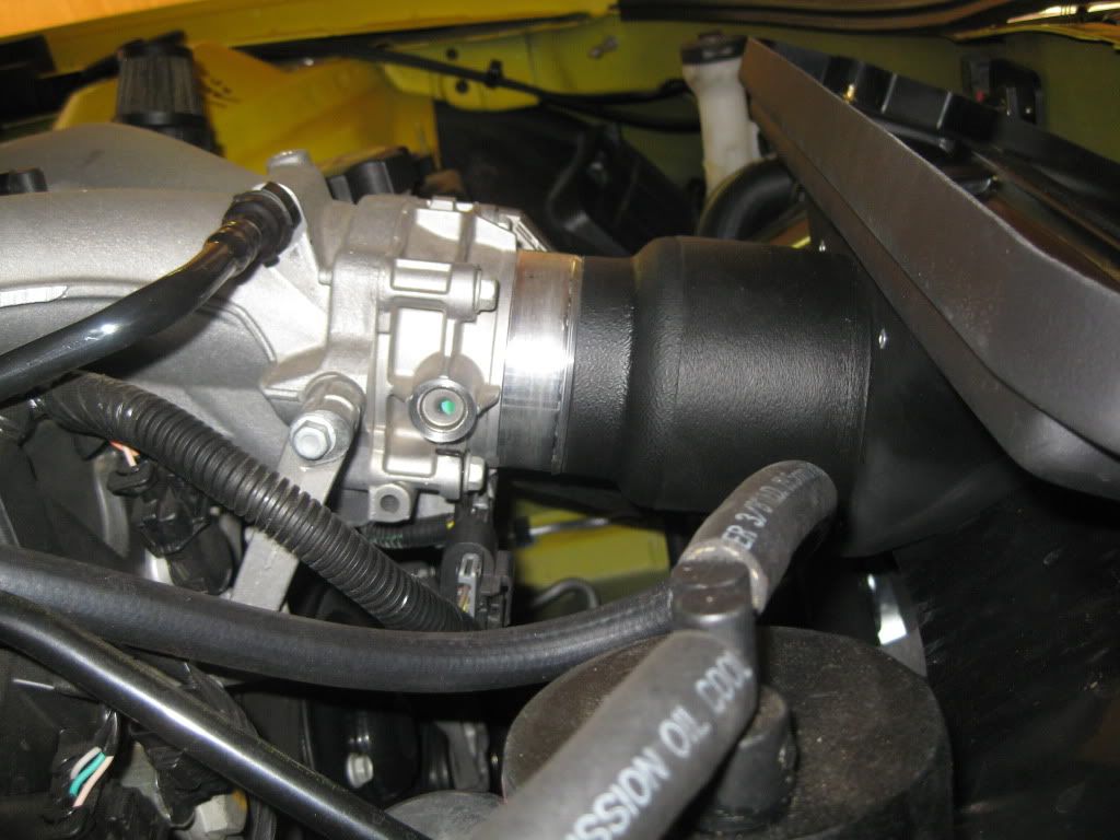

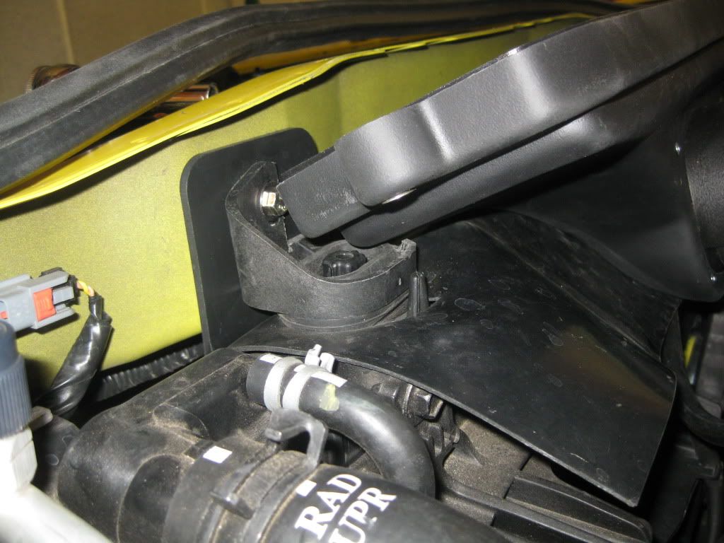

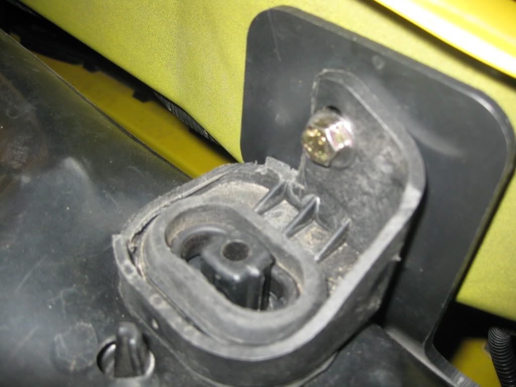

Some pics of my VR install, hope it helps. I have no issues.
I took a little more material off the bottom of the radiator bracket so the outside front edges of the VR doesn't rest on them.
The top of the rad leans back just 3/8", the width of the supplied rubber grommet and the wing. I didn't remove the hard plastic inner grommet from the bracket.
The top of the rad is stable just like from the factory.
The VR tube lines up flush with the TB with some play at the front.
No problems, it's called modding.
EDIT: Agree with bmore, it's just an intake and adding my last input till the fall.

Thanks for the pics 67 GTO, looks good. I hope mine fits as well

love the install pics 67gto!! ^.^

GTO did you just file that extra bit off the radiator brackets?
