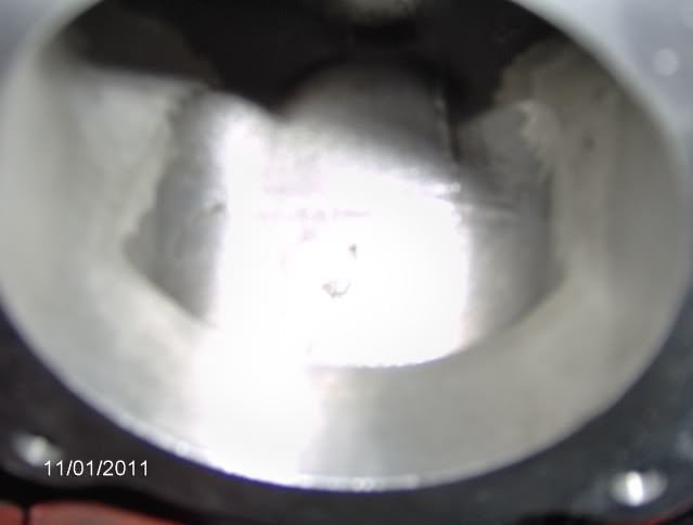

Here is a picture of the LLT V6 intake manifold. Look just inside of the snout where the engineers built in a dip to collect and trap oil:
