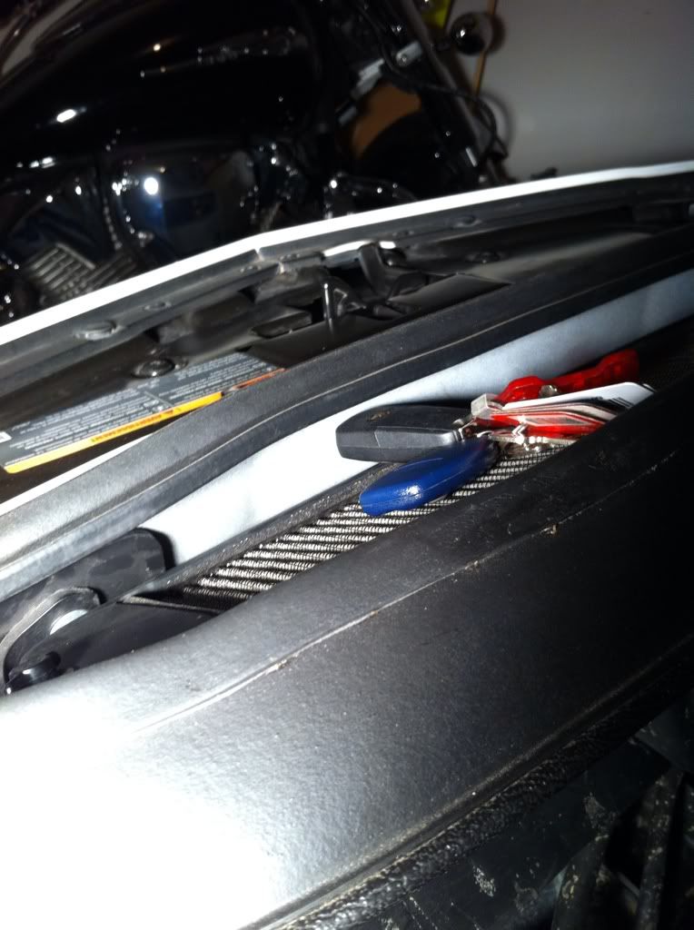

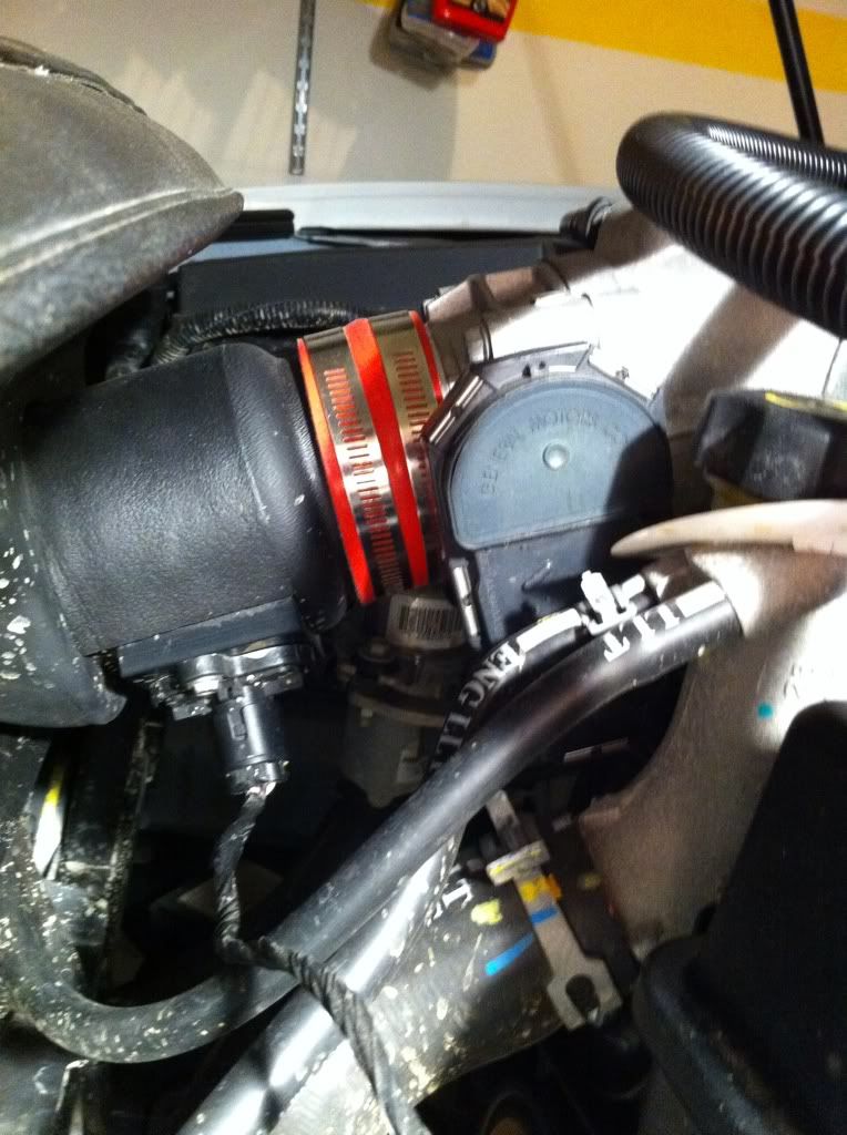

There is no need to cut because the angle isn't big enough. Only a couple degrees on the horn give you much more gap on the front of the Vararam.
So finally got into town last night..
Here is the horn against the throttle body.. The VR tilted down a few degrees...
Here is the gap.. It's so big my keys almost fell in. LOL!!!
Just to give you an idea how low the front of the intake sits now.. Look at the arrow. The intake housing is lower then the top of the radiator bracket....
