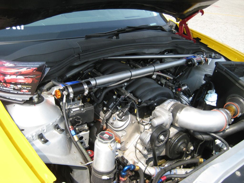

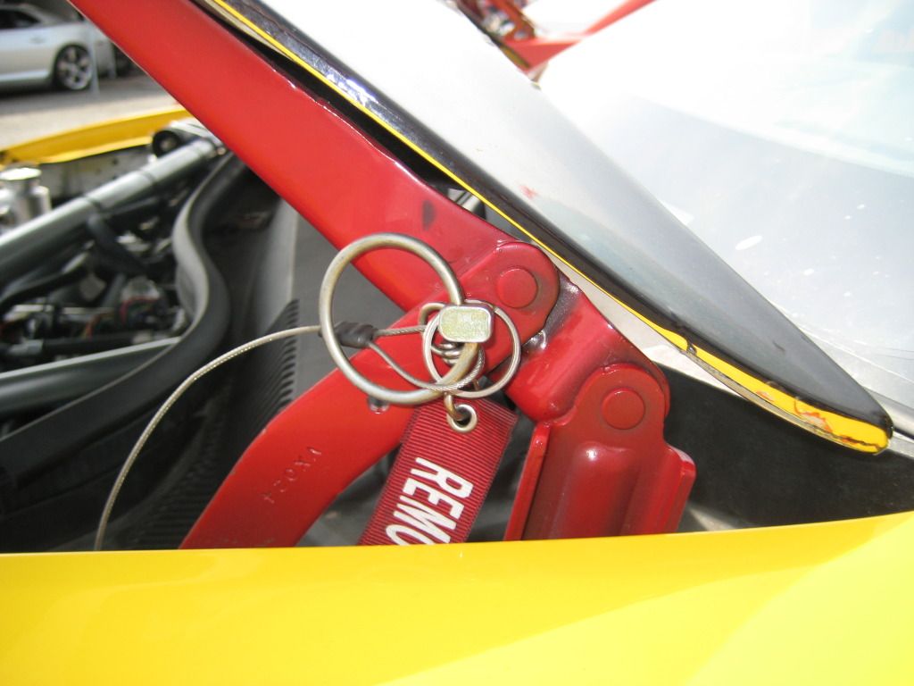

Here is the only picture i can find at the moment...
This was on the LG race car. They used hood pins in the existing hinges. Now obviously we can clean this up.. better looking pins, better lanyard, a spot to "mount" the pin while its not in use, ect..
Now i wouldnt do this on a normal car as the hood would probably shear the pin (pins if you do both sides) but ours is light aluminum (or carbon fiber in my case).

also a wider angle picture...

Stache, forget your picture taking skills because that right there is the money shot!!!! Thanks so much for bring this idea to the table. This gives me a lot of ideas on how to implement it. And Like you said, it totally does away with the hood strut problem
