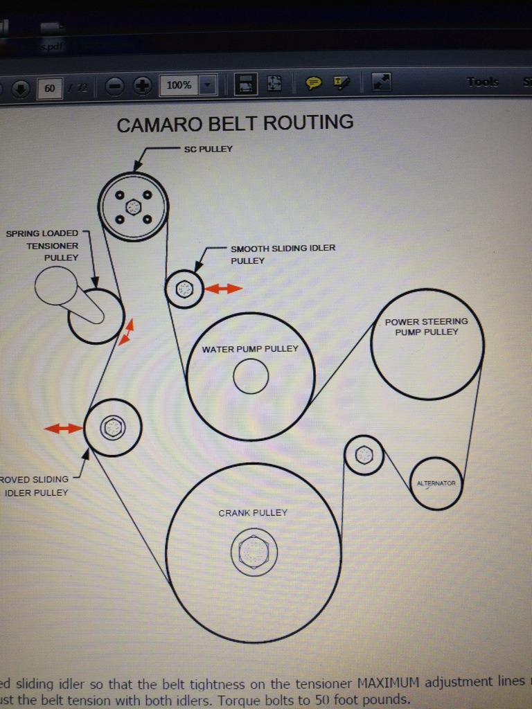

Here you go.

Ok, I just put a 3" pulley on my Edelbrock and my shop said I shouldn't have a problem with the belt but gave me the belt number. I would be shit out of luck if it does happen because I have no idea how to replace it. I don't beat the hell out of my car but sometimes when I'm at a stop light and someone pulls up beside me I just can't help myself. LOL
Supermaro585HP is offline   Reply With Quote
Old 01-29-2013, 06:58 AM   #17
ToddB
Drives: 2011 2SS Convertible Supercharged
Location: WI Cert Welder Navy NSSN
Posts: 1,157
I have a spare belt and a bar to release the tension on the tensioner in the trunk at all times.

Thanks - I printed and put pic, belt and socket in trunk with tire inflator

I have a real problem throwing the serpentine belt at high RPM. last one damaged my hood. anyone know of any aftermarket pulley systems that hold the belt? I have a magnuson supercharger on my LS3 with a comp cam.

JRE super tensioner, ECS tensioner, OD crank pulley and bigger upper, or OD rear cogs, 8 rib, 10 rib. One or all of the above will help.

Make sure you have the updated tension with bracket. In addition to keeping a spare belt I now keep a spare tensioner. I broke my original one at the track this year.
I can provide you with the part numbers if needed.

I have 30K miles on the E-Force now. I'm stilling running the stock Gaterback belt that came with the S/C. I don't take mine to the track, so I haven't had any problems with the belt slipping or the tensioner. I do carry a spare belt in the trunk though.

The gates HD belt is no longer green it is blue and part number is K060854RB

I've ran the green belt and the gatorback and the green belt stretches more.

They have always had the blue belt,it was suppose to be better than the green but they never made it in the size we needed. The GREEN has been the tuffest weve used but there getting stupid high .

Huh that's odd cause on the gates website they don't list the green just the regular one and the race (blue) one.
