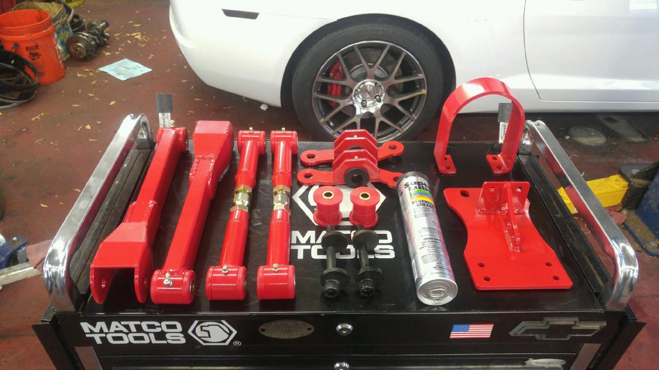

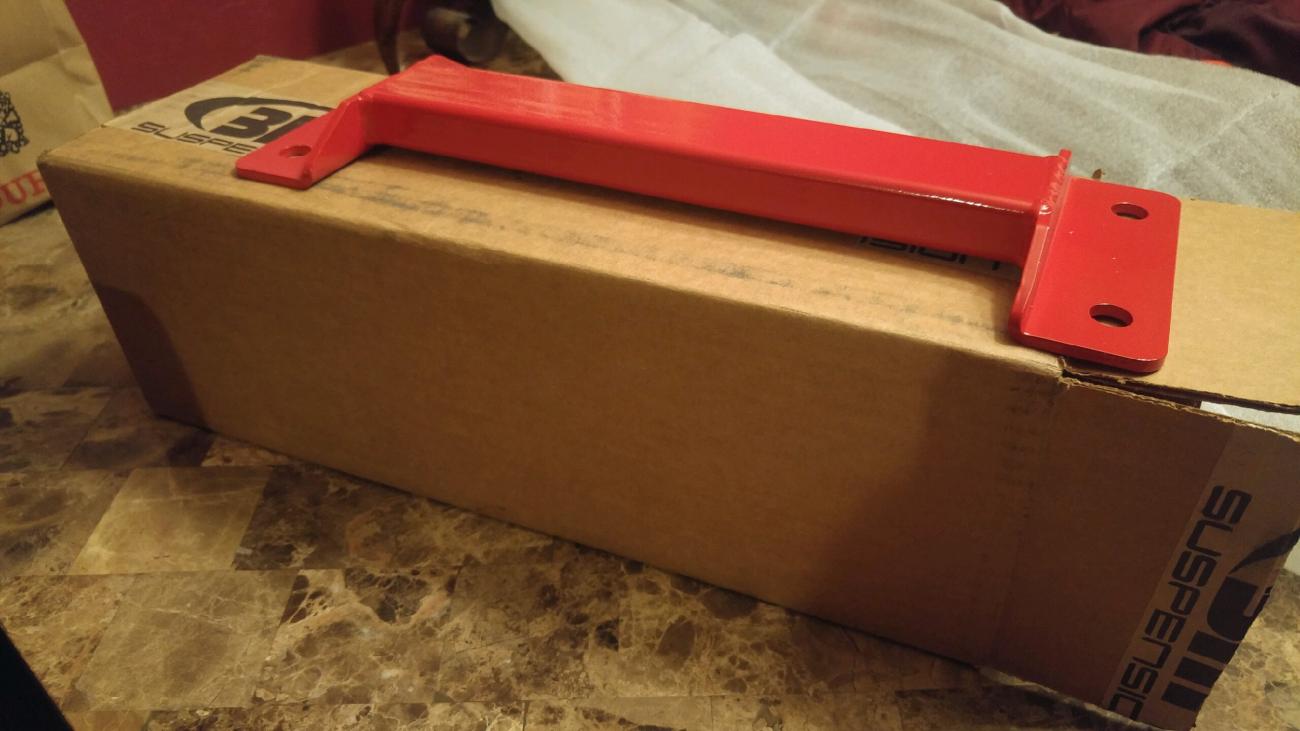

My BMR suspension parts came in today, well most of them anyway. For some reason the subframe bushings didn't ship. I'll have to call and see why tomorrow. Got trailing arms with outer bushing, adjustable toe rods, upper control arm bushings, cradle bushings, camber bolts, driveshaft hoop, tunnel brace, and a tube of synthetic grease. All the bushings are polyurethane except the upper control arm bushings which are delrin. I bought the tunnel brace just for looks and because it was only $50 shipped with the black Friday sale, I don't really expect anything out of it performance wise.
I decided to go with red on everything, I figured it would match the red brembos and look good on a white car.

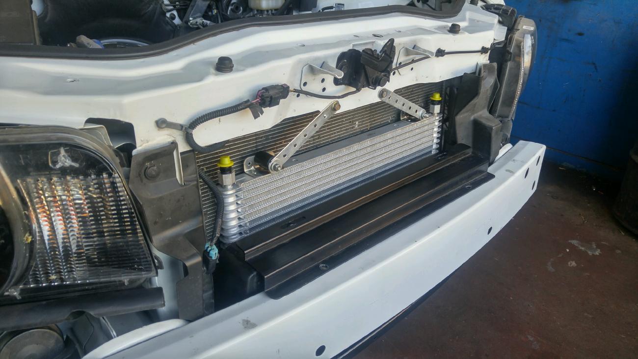

The transmission cooler isn't going to fit where I was planning so looks like I'm going to have to mount it in between the condenser and intercooler. Fits pretty nice in there and has at least half of the core above the intercooler so should still work well. I'm not crazy about the erector set looking bars so I might see if I can find something a little better looking.
