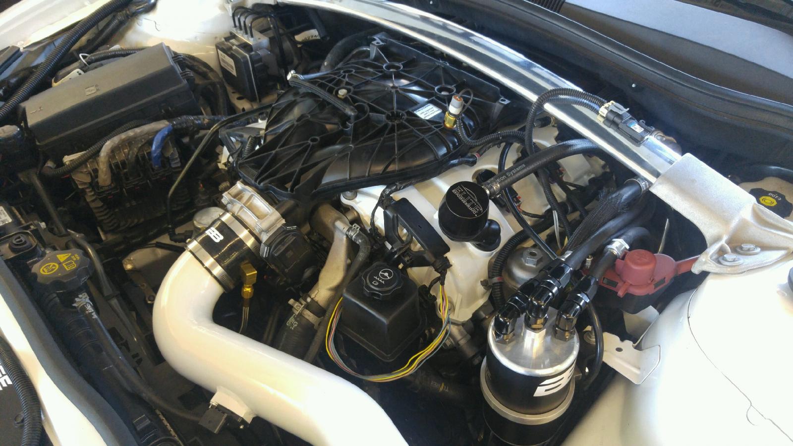

I went ahead and removed the air straightener piece of whatever it is that's in the throttle body opening of the intake.

Wiring in the sensor breakouts. For the Baro breakout I used a MAP sensor out of a 01 Camaro 5.7L and need it just open to the atmosphere somewhere in the engine bay. I decided to drill a hole and mount it on the strut tower brace. That outta make people scratch their head lol. I wanted it somewhere where it wouldn't get filled with road dirt and dust.

Wiring is done. I started it up and it didn't explode so I must have done it right.
