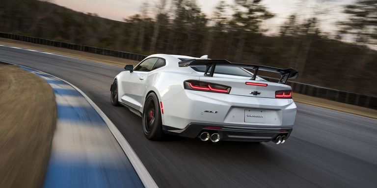

Originally Posted by SlingShot View Post
I think the bigger question would be, why are these young V6 guys so temperamental?
i agree 100%, must be straight out of high-school and wanting to be bad ass, i know how that felt.

Originally Posted by SinginHawk View Post
Also, do you have any insight into whether or not the deck lids have similar enough shapes for a three point fitment to work?
I think the only real question would be the mounting points of the outer posts in relation to the trunk lid. It would appear that those posts are far enough in that they would clear the top of the rear quarter panel on the C5. It does appear that there is slight more curve to the rear on the Gen 6, but not enough to really make a difference, especially with a raised wing like this.
The part of this to really consider is the support, or possible lack of support for the mounting points. You don't want to bolt a large, high wing like this into thin flat sheet metal, it needs to be bolted into the support molding in the trunk lid.
BTW, this is only a waste of time if you let yourself get wrapped around the axle by the posts that express opinions of why you should or shouldn't do this. Let that stuff go and stick with the ones that honestly trying to help. Understand that none of us really have the "answer", as many of us haven't seen the car in person. I personally haven't seen the support structure for the Gen6 trunk lid, though I've been parked next to a couple and can say that there isn't much difference in the general shape of the rear end.
Anyway, good luck, keep asking questions. Remember, every problem has a solution...and every solution has a problem.

Originally Posted by DRKS1D3 View Post
At what specific point does a spoiler become a wing? When the piece parallel to the trunk lid is raised by 3", 8", 22"?
IMHO, the term "wing" was always reserved for 1994 Hondas that have been given the Fast and Furious treatment.
IMO a spoiler is vertical and a wing is horizontal ...
A spoiler disrupts (spoils) the airflow between the roof and the rear of the car to prevent lift. Otherwise air flows from the trailing edge of the roof to the back of the car in a bee line. Leaving a hole under it and creating a low pressure area on the deck lid.
A wing provides downforce.
