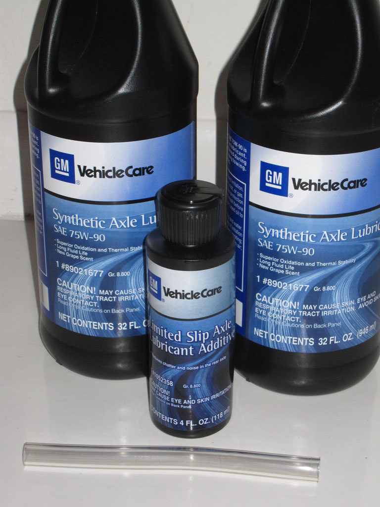

$83 from a dealer's parts dept. for all three bottles. If you look around online, you can probably get it for half that. All are required to refill the diff on a V8.
Guy said the small bottle of additive gets poured in first to a fully drained diff, then the other two (until it spills out the upper fill hole). Car MUST be level when doing this (use all 4 jack stands).
SSLarry is offline   Reply With Quote

Originally Posted by SSLarry View Post
Attachment 149718
Attachment 149719...all three bottles.....All are required to refill the diff on a V8.
NOT true. You only use 2.5oz of the additive and 1 bottle (1 quart) of fluid. It all depends on how reasonable your GM parts counters are on costs. The ones in Wichita are ridiculous and I paid just under $50 for one bottle each of fuid and additive.
As far as whether to use the GM or aftermarket fluid, here's a post where I was wondering just that and why I decided to go with the GM stuff: http://www.camaro5.com/forums/showthread.php?t=89568
I forget what the torque is for the drain & fill plugs, do a search though and it should come up.

Originally Posted by Ron66Vette&10SS View Post
NOT true. You only use 2.5oz of the additive and 1 bottle (1 quart) of fluid. ....
Yup, you're right...manual says 1qt of the fluid. So why the f#@& did he sell me double the quantity?? I'm taking back a qt tomorrow for a refund of $33.
As for the quantity of the additive, where do you get 2.5oz? Is that in the service manual? It says nothing about qty in the owner's manual.
The 2.5 oz thing is in the owner's manual. It's on the page for Capacities and Specifications. It shows 1 qt then an asterisks that points to:
*Add 2.5 oz. (75 mL) of friction modifier to the specified quantity of axle lubricant.

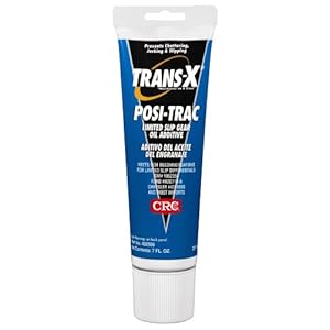

Where do you get the friction modifier (per GM spec 1052358)?
do you have to get it from GM?
part #?
EDIT:
I want to use:
1 of these...
http://www.amazon.com/Mobil-75W-90-S...f=pd_rhf_p_t_2
and 2.5 oz of this...
http://www.amazon.com/CRC-402508-Tra.../dp/B000M8Q1D0
instead of:
It looks like they both meet the GM specs.
