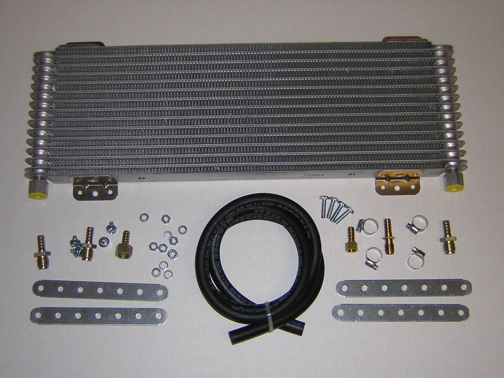

I ordered a Tru-Cool 40K transmission cooler today. I'm sure it's overkill but I figured why not. I've measured and measured and I'm pretty confident I can make it fit nicely above my intercooler. Dimensions are 22" x 8.5" x 1.25". It's a plate and fin style and huge so I shouldn't ever have to worry about tranny fluid temps.
Also ordered some ARP2000 connecting rod bolts and some DEI Titanium header wrap last week which should be here tomorrow. I'm going to wrap the pipes from the cylinder heads to the turbos to try to keep as much heat in as possible.
