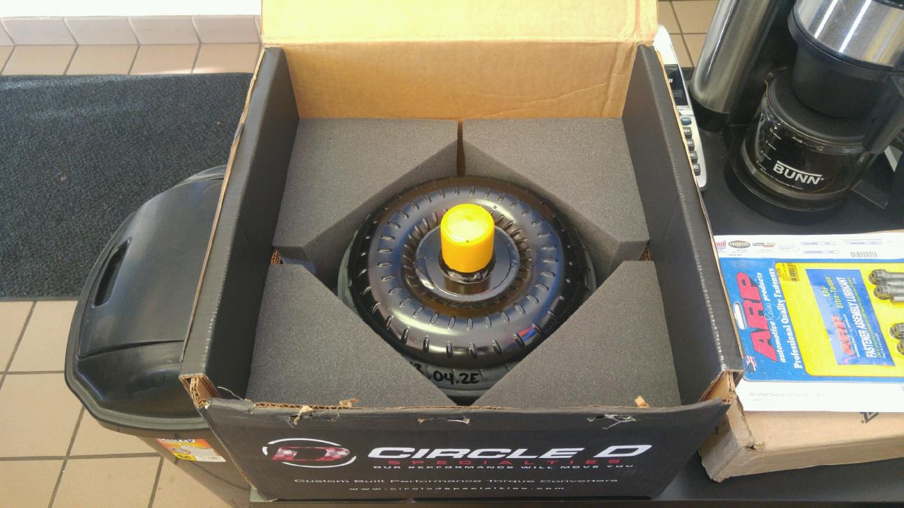

CircleD torque converter came in today. I ordered it through Aaron at Gwatney. It's the billet triple disc in a 2E. Not that anyone will ever see it but this thing looks really cool. Toughest looking converter I've ever seen that's for sure. Can't wait to test this baby out.

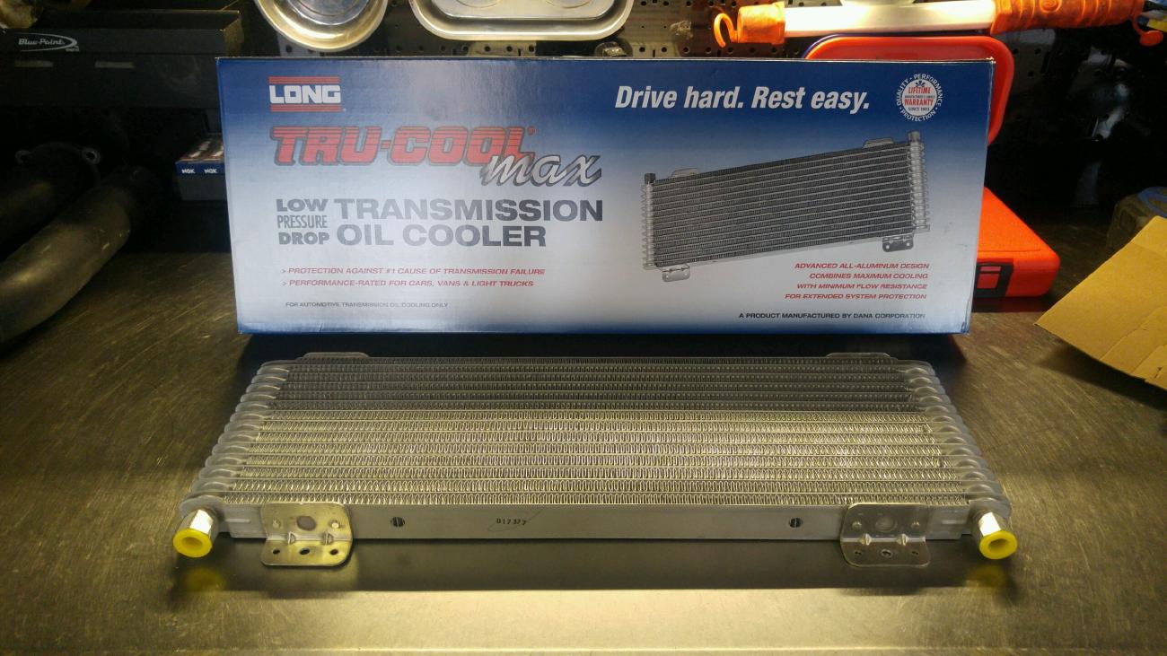

Got my transmission cooler today, it's bigger than I thought by the dimensions. I figured dimensions were of everything but it's just the core of it not the fittings and mounting ears. Its big but I still think it will fit. I'll have to remount the intercooler and radiator/condenser and see what I can come up with.

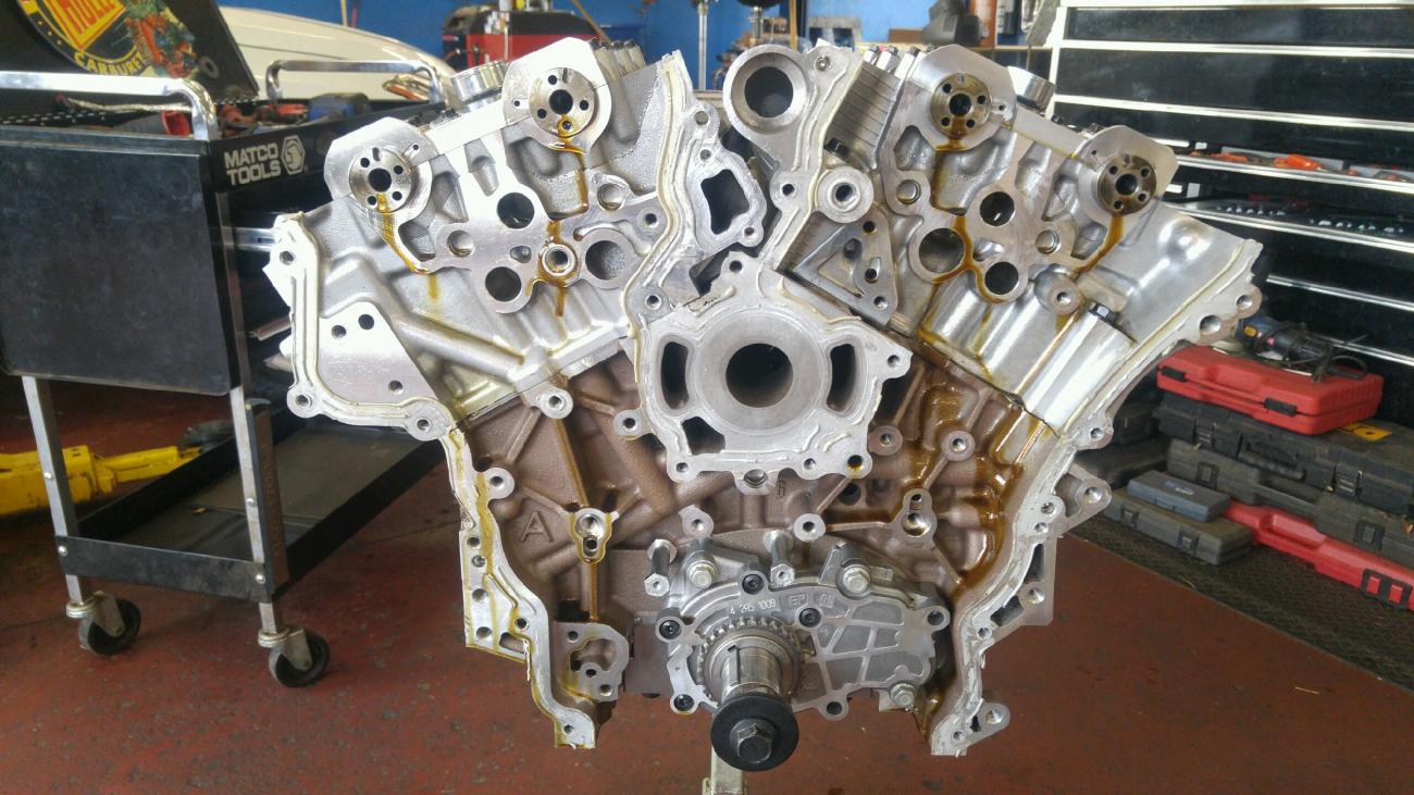

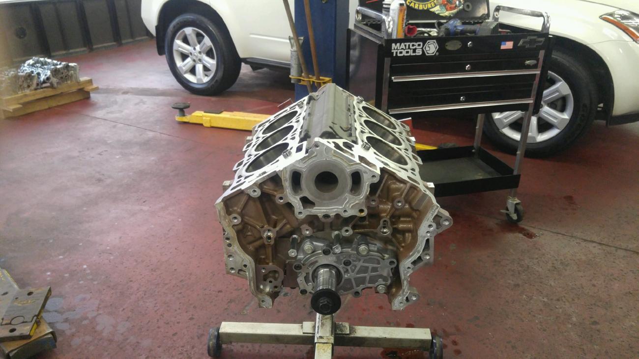

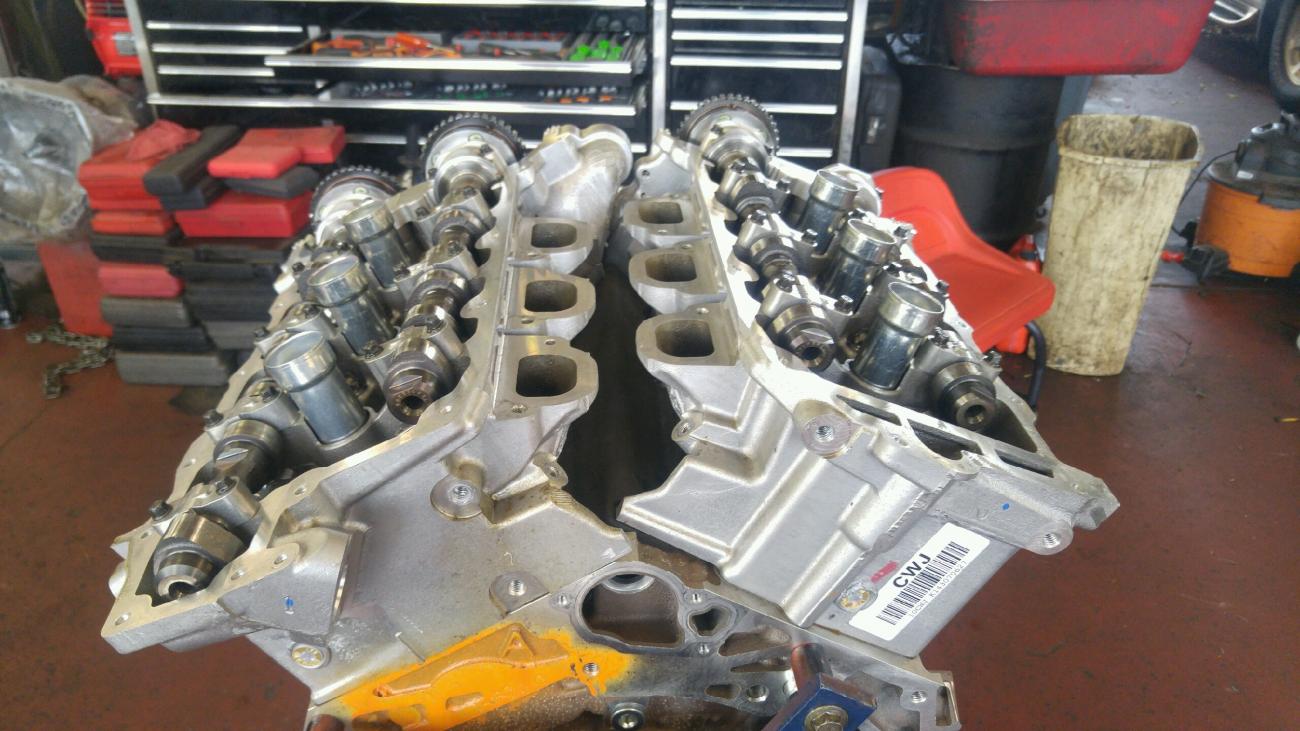

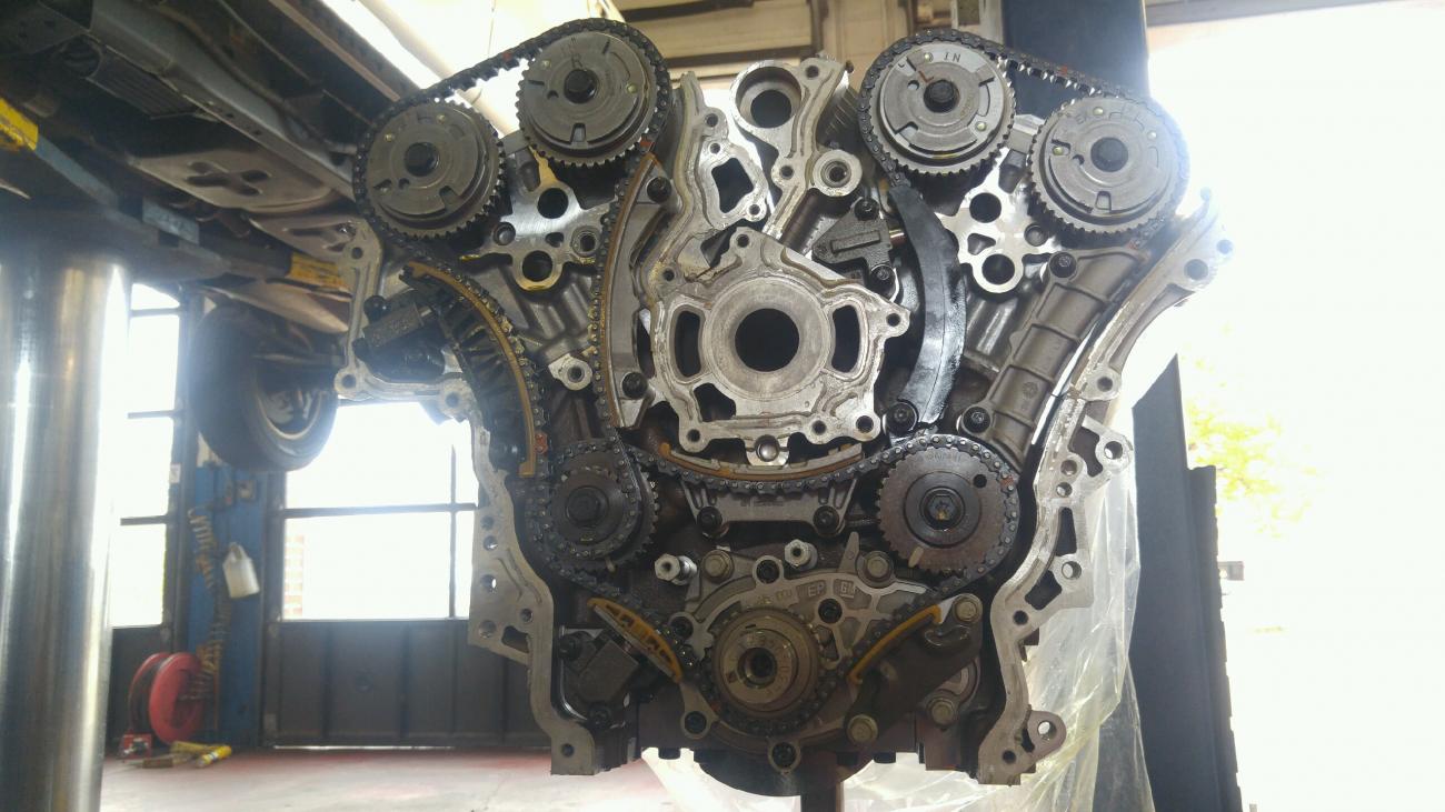

Just some random tear down pictures.
