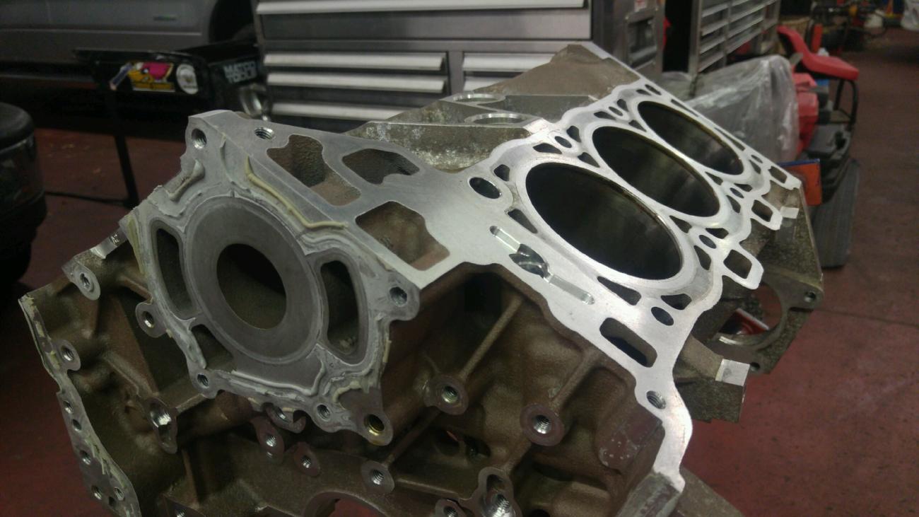

All tore down and ready for the machine shop.

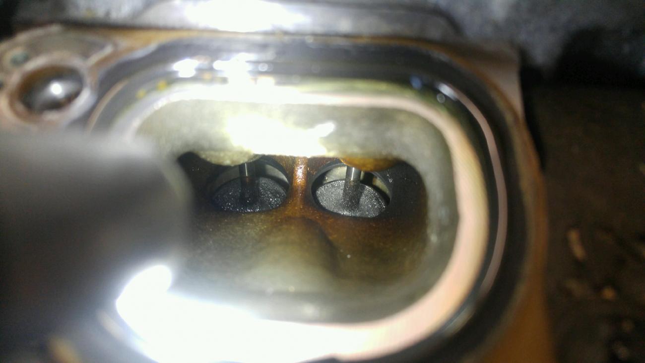

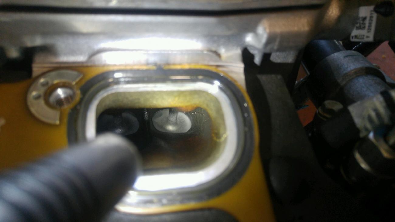

These are pictures of all the valves from this '15 LFX heads with only 5k miles on them. #1 and #2 are the only ones that have oil/carbon build up and #1 is really bad. The rest don't look nice and clean but they have more of a white build up on them.
This is #1, #2, and #3

#4, #5, and #6
