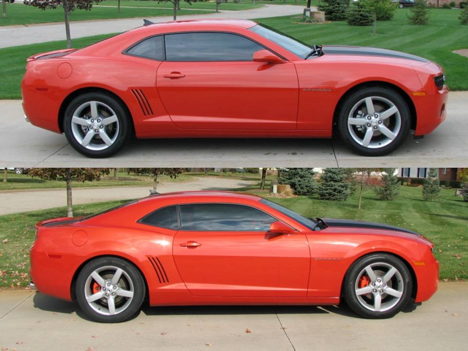

Originally Posted by xpanda305x View Post
i have been thinking about dropping my camaro 1ls with 19in 2LT rims and i was wondering what would be the pros and cons about dropping my car on some springs. i dont know what brand im leaning to yet. so if someone could guide my to the best springs to drop the car on it would be good. i am not looking to SLAM my car. just a drop so it doesnt look like a 4x4
Eibach springs on my 19" 2LT. Dropped it approx. 1.25" in each corner. I did this for the looks first and for most. Love how the Camaro looks when the wheel wells are filled a little more.
Here is a before and after and one when going down the dragstrip (my favorite photo of my Camaro).
Good luck. There are many good companies to choose from.
http://www.camaro5.com/forums/showthread.php?t=112638
