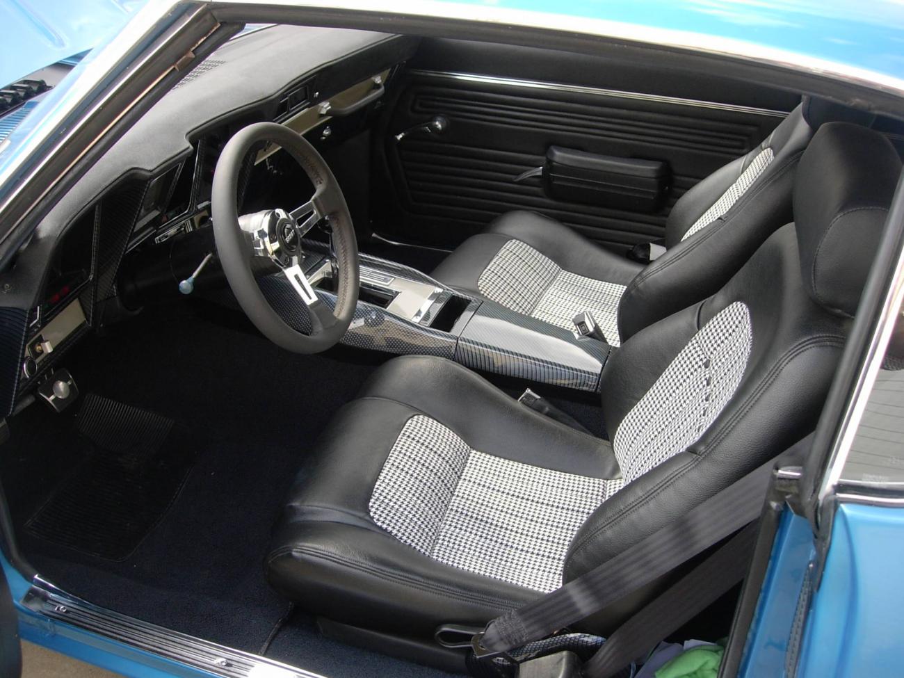

New houndstooth covered Firebird seats! After driving in the 2010 I can hardly take the non-reclining "L" shaped factory seats in my '69.
