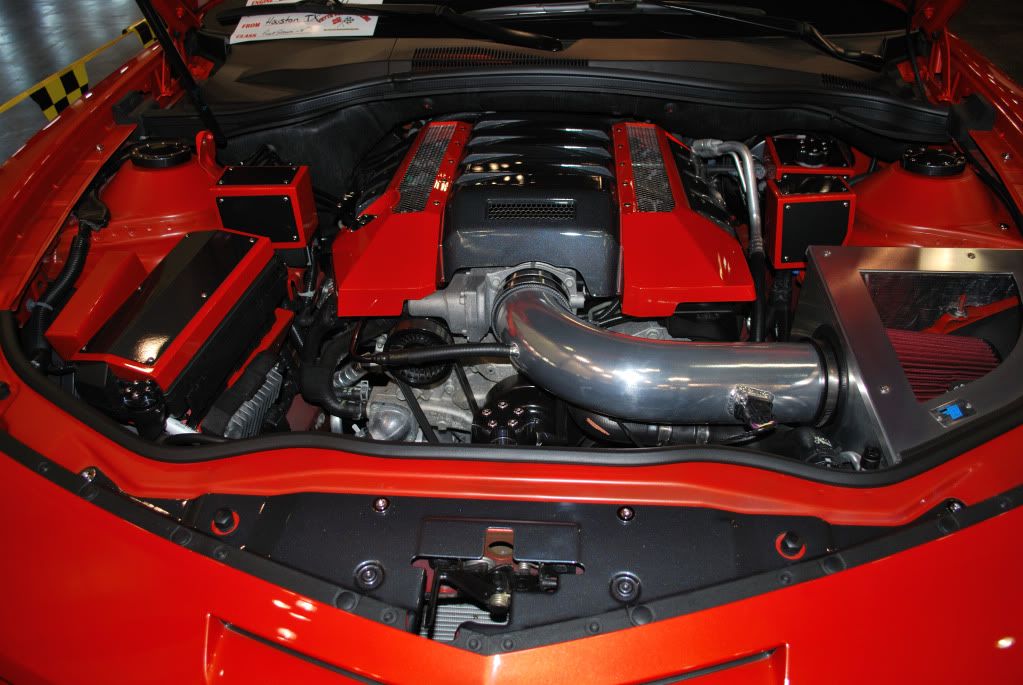

the wife saw a painted engine cover at a show last week and now since i paint houses she wants me to paint hers. i bought the IOM spray paint from the dealer and was wondering the best way to do this. it says on can to use 400 grit sandpaper before painting. should i sand the plastic before painting or should i just clean it real well and prime it with some primer that helps paint stick to plastic? or should i just clean it and spray it with the paint i bought no sanding or primer?

I painted my friend's synergy green cover, we cleaned it down with rubbing alcohol, primed it, and hit it with 1/2 paint & 1/2 reducer in my hvlp sprayer. One shot was enough..it came out great.

Absolutely, I even did my SS cover this way, the only difference is I used SEM spray paint for my cover. I don't really have a use for all that paint, otherwise I'd pull out the hvlp sprayer.

love that look with the vararam. how do you like the vararam?
