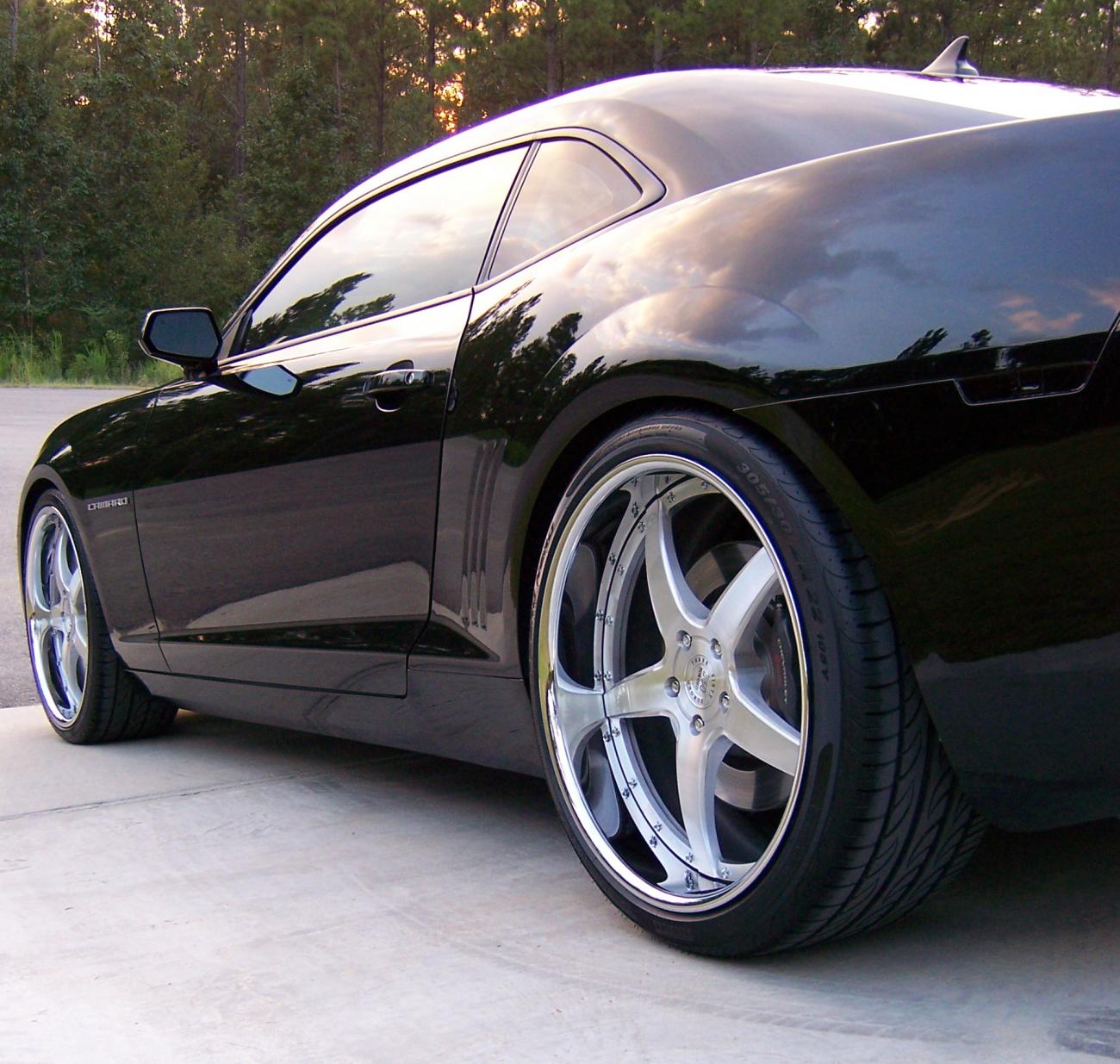

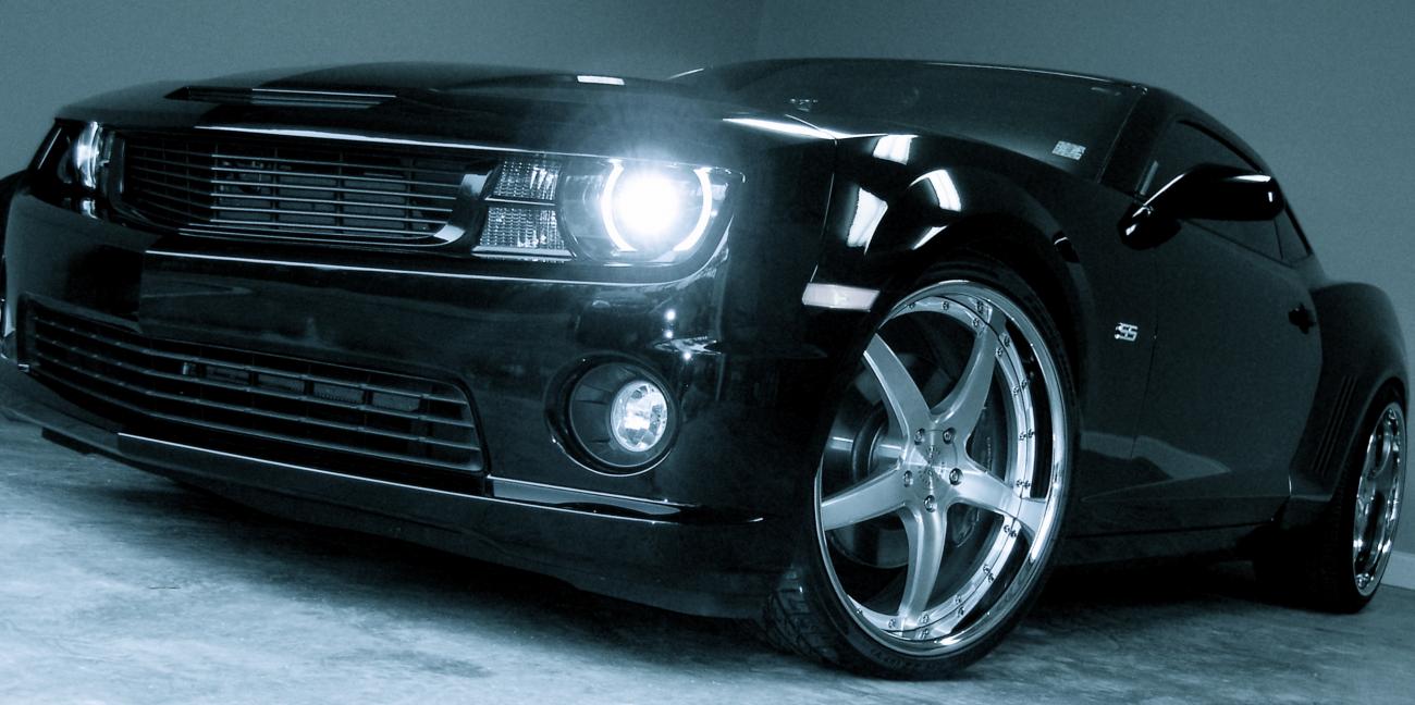

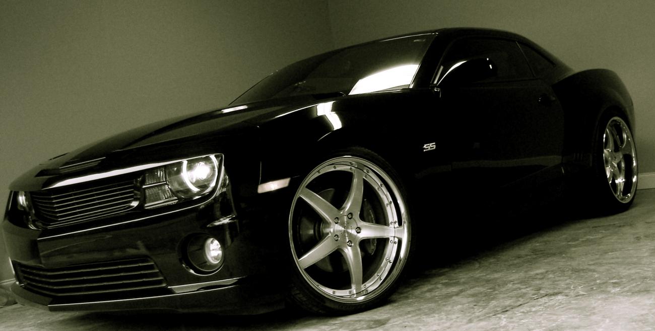

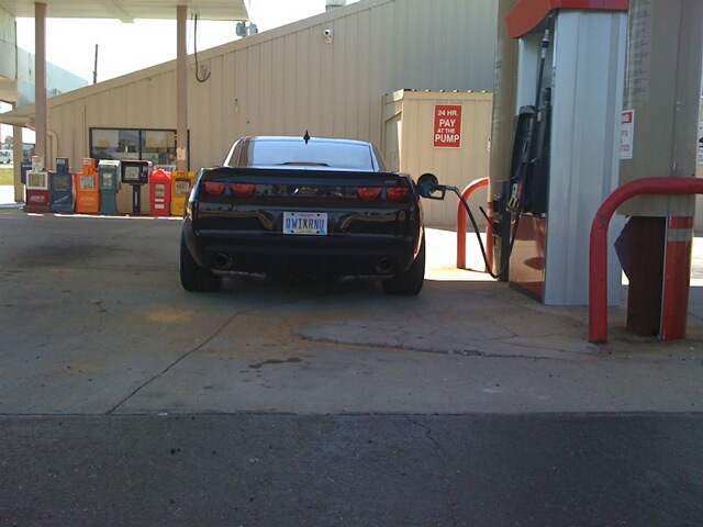

22x11 and 22x9 w 305/30 rear n 265/30 front
Attachment 219213
Attachment 219214
Attachment 219215
Attachment 219216
That combo looks fantastic... best looking set of wheels I've seen on a Camaro yet IMHO.
Not a big fan of the riveted look, but that wheel/tire combo is the best looking aftermarket set up I've ever seen on a 5th gen.
