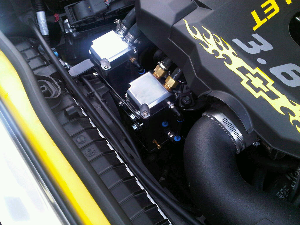

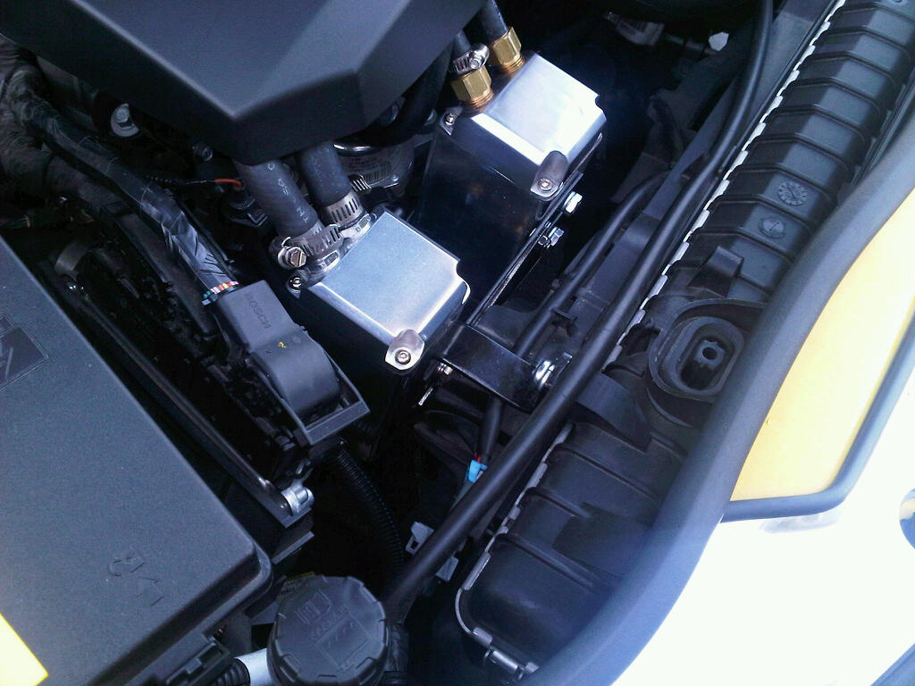

So I'm in the middle of my install and I need some major help lol. Does anyone know what I need to do if I threaded the hole in my radiator where the catch can bolts on to? My catch can is just kinda free hanging now lol and I'm afraid to drive it like that. Thanks!
Are you talking about the screw whare I attaced mine.
if SO I REPLACED THE eom BOLT BY A 7-16 REGULAR TREAD BOLT 3-4 INCH LONG
It did it's own way and very solid, it's now holding 2 catch cans.
Here's 2 pics:
Name:  catch can install 1.jog.jpg
Name:  catch can install 2.jpg
Here's 2 pics:
Attachment 238196
Attachment 238197
oh wow. Thanks for the tip. I just left home depot but I picked up 5/16 regular thread and 2.5 inches long instead. Didn't see your post soon enough. You think that will work? And did you just use that new bolt and screw it in? You didn't use a different tool to re-thread the hole did you? I really appreciate it .
I just used the other bolt. It screws into plastic so the tread did it's own way and since it's much finer it holds better. 3-4 inch is the longest to use.
