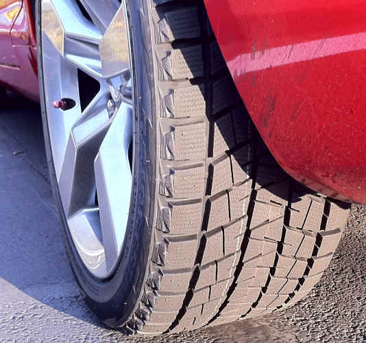

I've been thinking on this and staring at different tires for days now. What stands out to me is the tire tread edge itself. What I mean by that is, there's a hard edge on the blizzaks, and a rounded edge on the others. I'll attach a picture I took close up the day I had these put on at bottom of post.
I think, due to all the reasons mentioned so far, and this edge, when you simulate a swerve around a pothole, that hard edge rolls and creates the noise I would hear. Basically you drop off that edge too far. Even at 50 lbs pressure.
Once you have dropped off the edge of the tire it really goes out more than is safe.
I'm no tire expert, but I have always tried to purchase the best when it comes to what my wife of 30 years drives daily. I have never come into this sort of situation before either so am of course struggling here to understand it all. All I can come up with on my own is that edge.
Looking at this image up close it seems reasonable enough to me that once you get to (and over it?) that edge it might pull a bit more than some other tire similar.
That pull, that feeling was just to much to feel safe for me leave them on at all. I'm with you Dan, no blizzaks for me, not on this Camaro.

Thank you for the replies, folks! I definitely appreciate everyone's input. I can see how the sharper sidewall edge may possibly contribute to altering the slip angle of a tire, compared to a stock one. Yet another reason (of many) to never ever mix and match. Infopro, let's chat at some point today about our options.
