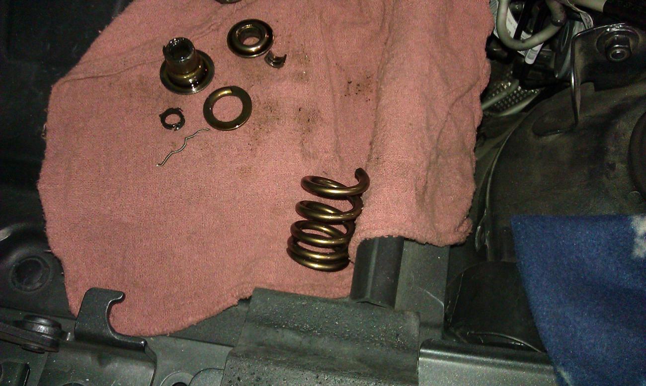

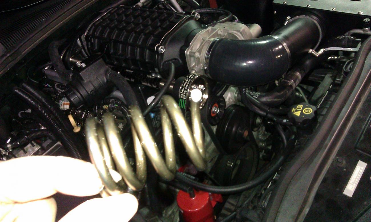

:( yeah soooo... My car lasted 2 whole days after getting my supercharger(2300) installed. Went out on Wednesday to run a few errands and decided ehhh WTH I'll take the camaro! Never made it... I was cruising along about 38 mph ish and punched it. It ran fine the day before but this time it sounded "funny". I could see that the car was making boost*around 6-7 psi* and it was injecting methanol according to boost as it should.
No loud pops or bangs, it just felt like a misfire of some sorts. Horrible idle and stuttering. Soo I popped the hood and the actuator/wastgage? on the maggie is moving back and forth with the rpms WTF!?!?
Long story short got it towed and yeah broken valve spring. I was running Mast's VVT stage 1 cam and nitrited beehive springs.
The car had been cammed for almost a year only one issue..It threw a cam over advance code on long trips but always cleared itself.
What could have caused this...any ideas or next course of action? Should I call MAST

Update: No it was not the stock springs.
I bought bought cam and springs from Mast.
The valve is also bent!!

So does Mast back those springs for any amount of time? You gonna pull all of them and replace? I'm assuming the head is coming off to check for more (if any) damage. That sucks.
No idea. I'll find out on Monday if their willing to do something for me.
Originally Posted by CyberPredator View Post
generally on cars you don't drive very often that have extreme valve springs with a big cam(granted i have no idea how big your cam is) you change the springs once a year. From what I hear with the car sitting for long periods with some of the upgraded valve springs fully compressed they tend to become fragile. On race engines the rockers are often released after racing is done to take pressure off the valve springs while the car isn't being used. All of the previous things stated are gathered from info over time, some maybe true, some maybe false, just something to think about. On my built gto i ran very similar springs and put 28000 miles on them with no problems but it was all in 1 year and then changed them after a year because of the things i previously stated
The car is driven quite often. I think your referring to dual springs. Beehive tend to last a bit longer, It was one of the reasons I went with them..
